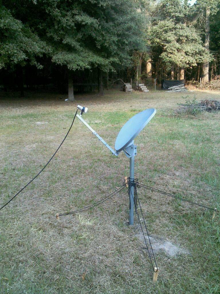

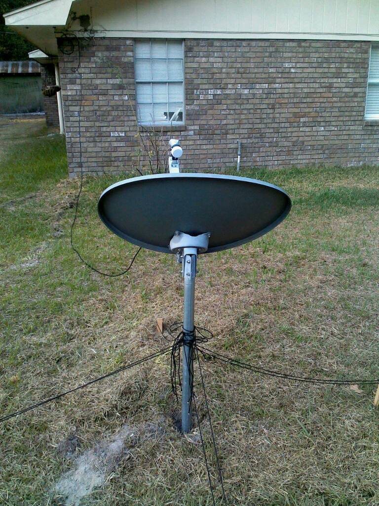

said that the focal length for my antenna (Dish Network Superdish) is 21.75"
On an offset dish, that would be measured from the bottom lip of the dish.
When you get it repositioned, maybe the mirrors and a street lamp a block or so away, as a light source? Haven't had to do it, just thinkun.:eek:
Wouldn't it be nice if the measurement to the top lip were also noted?
Then the exact focal point would be known.

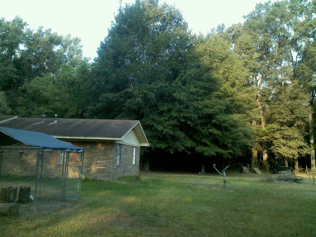

Just remember, to aim at the street lamp, the face of the dish may be pointed at the ground half way to the pole it's on.
Instead of concrete, hold the pole plumb, and tamp in gravel or small rock. Have some 'wings' on the bottom of pole or a piece of ready rod thru a couple of holes to prevent it from turning. Then if it's not permanent, pull out the pole, the gravel level drops, cover with dirt.

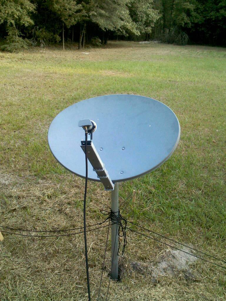

Thanks for all of the help. I tested the dish with mirrors this weekend and I never could find the focus. The best I could do was to get two points focused. I've decided to stop with this dish for now, and I've ordered an 80 cm dish from Sadoun. I'll let you know how that goes.
I just thought I'd post an update. I finally got the 80 cm dish installed tonight and it works beautifully! I'm picking up lots of stations from Galaxy 19. Now it makes me want to put a motor on my dish or continue working with my original dish so I can pick up other satellites, but that'll come later. Thanks again for everyone's help!
