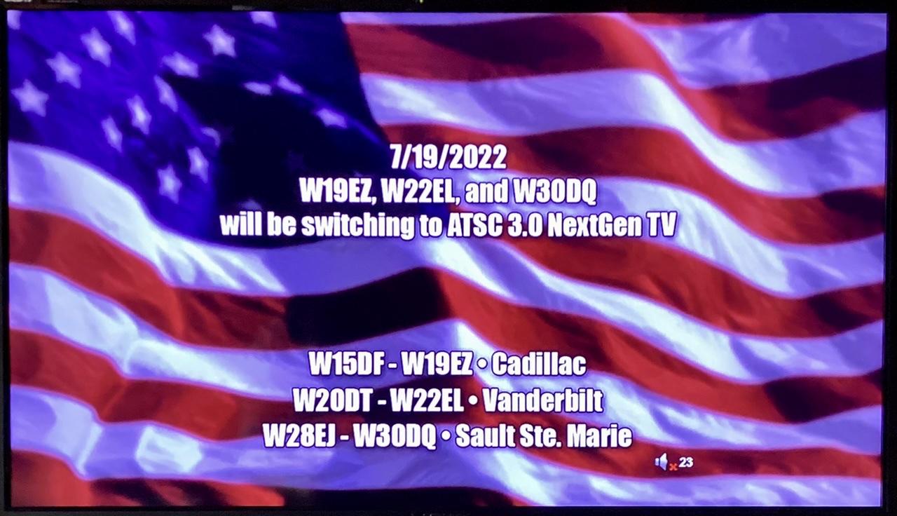

I have arrived at our family Vacation Home and found two out of the dozen or so OTA channels are working, the rest had no signal. I did a rescan and came up with 8 channels found: six for WFUP 45-01 thru 45-06, 22-01 (ID'd as DTV by our Dish VIP 211), and 20-01, also ID'd as DTV.
Tuning in either of the two "DTV" channels a slate is shown with a -20 dB 1 kHz test tone:
So, I guess it's safe to assume that whatever TV receiving technology we are using currently is now obsolete. I wonder what we're missing?
According to RabbitEars, the three channels are on 20, 21, and 22, all located on the same tower, just over 50 miles away. With the rain and high-humidity, the other channels (27 & 31) we should be seeing are not showing up. Ah, hiding channels not on the Air makes those two vanish. But WGTU (29) and WPBN (35) should come in and I will need to wait until the conditions improve.

Those upcoming ATSC 3.0 stations are for the Evoca Michigan market--Info.: The smart, simple way to watch TV! and Evoca Launches in Northern Michigan - 9 & 10 News .
