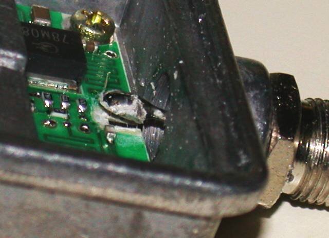

Well, today I learned the hard way why we don't torque the bejesus out of our F connectors with wrenches and the like. I had used a wrench to gently tighten a cable onto my LNB. Well, today I wanted to remove that connection and couldn't do it with my fingers, so I got my trusty Leatherman tool and proceeded to twist - the wrong direction. :eek: Before I knew it, the nut at the top of the connector, the one that's on the LNB itself, started turning and I knew I'd hosed it. Sure enough, I hooked it back up and got nothing at all. I did, however, take my LNB apart and take a few pictures.
In the first picture you can see that I've managed to tear the solder pad right off the circuit board altogether. I must have twisted the thing 360 degrees before I noticed what I'd done. What looks like a scratch on the stripline traces in the background is actually a circuit board trace sticking out of that big solder blob straight up into the air.

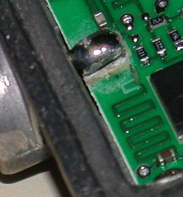

The second picture gives another view of the situation. Look closely and you can see that I've torn some of the stripline circuitry right off. I'm pretty handy with a soldering iron and ordinarily I'd just try to repair this, but that torn stripline makes me think I shouldn't even bother. Everything's so damned critical at these frequencies. It might work or it might not - at least this is damaged at the low-frequency end of the signal path, so I might stand a chance.

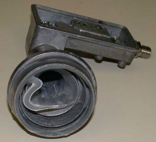

The final picture is what I saw when I pulled the cap off the feedhorn. This is a "Besat" 0.3 dB LNB - the cheap ones you can find for next to nothing on eBay. It seemed to work well enough, but I can't help wonder if that huge glob of silicone sealant wasn't absorbing some signal. Maybe silicone is transparent at 12 GHz, but regardless, this is certainly a sign of shoddy manufacturing. Still, I knew what I was getting into when I bought it. I just wanted a cheap LNB to get started in FTA.

Pestie,
I think I would buy a new one too. Then I would try to fix the old one. If you use wire of about 22 gauge and follow the same path as the circuitry that was pulled loose it should work.
I think I would remove the silicon :>)

I used to work for a company tuning and repairing the other end of satellite communications - the transmission amplifiers. You wouldn't believe some of the things that I saw go out the door. Sealant would be a minor problem. Companies push for more and more output and less quality. It's amazing how good an amplifier can look once the final housing is put on. You never would know what's inside...
Solder spikes (a legitimate tuning technique) at various angles and sizes are actually used to tune the input and output impedance of KU band RF equipment. Judging from the looks of your LNB it looks like no tuning was used at all. Probably a 40 dollar piece just gets wave soldered, cleaned and shipped. Changing the solder might change the VSWR, but probably not by much. You might even make it better than it was in the beginning! Then again, think of what is said about powering up your receiver without the LNB hooked up. I assume that this is a VSWR warning.

Edit 2 - We used circular pieces of metal to tune the waveguides of our amplifiers. We'd use RTV adhesive to hold them on. I'd check the feed horn to make certain that there isn't some type of tuning under all of that goop before I removed it.

For what it's worth, I probably will try repairing that LNB at some point. It shouldn't be all that difficult and it will probably work fine. Even if I get a nice Invacom quad LNB I'm still going to want the wider bandwidth of the universal LNB. I'm in Florida and I can receive some Central/South American beams that use the European frequencies (the South American beam of AMC4, for example). But it's not a priority, just something that's nice to have on occasion.
