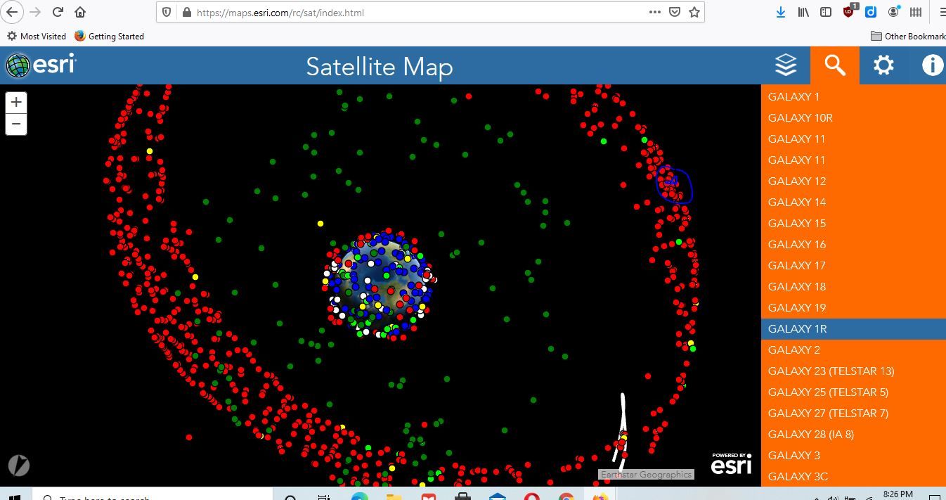

This is just amazing how technology works. Here is an image of earth with a plot of all satellites around our tiny planet. I found Galaxy 19 in this plot as well, the tiny dot in blue.
Here is the link:
And that doesn't include all the millions of pieces of "space junk" -- dead satellites, upper rocket stages, nuts, bolts, astronaut gloves, and other chunks of old space hardware -- orbiting the planet. It's starting to become a real hazard out there to the ISS and other functioning spacecraft/satellites. There are ongoing concerns about collision potential.
