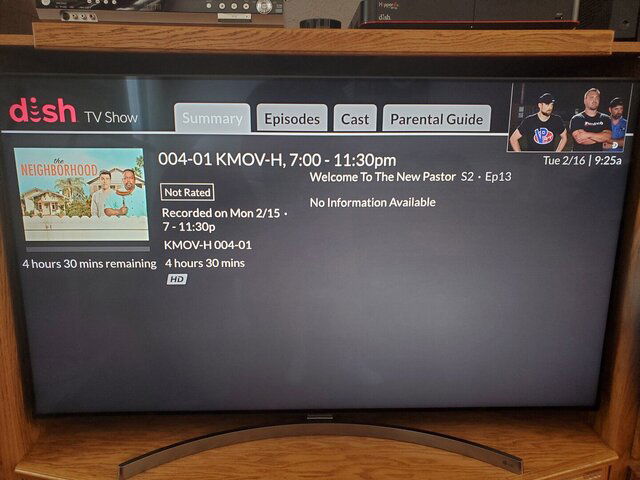

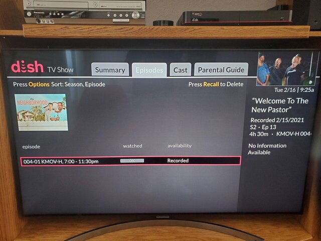

Performed a manual timer test for my two Hopper 3s. Did a blend of local and Sat channels. All the timer recordings showed up in my Recordings folder. Total of 7 recordings had no watch button when the recording was selected. However, 3 of them I was able to hit the Play button on the remote control and they then would play. As you can tell the issue is with the local channels, both OTA and Sat and not all PTAT. The issue is intermittent. Go figure. Let me know if you want any more test done. Wife is teaching school by Zoom so both Hopper 3s can be tested all day.
