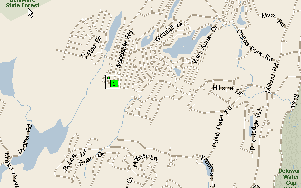

I've triangulated your approximate location from your TVFool report and fortunately you appear to be on top of a ridge, but NYC stations are still 2 edge from your location.

My mappoint program is showing this to be his location if the Latitude and Longitude were correctly given to use..
You are within a half a block from the location I used.
I put it in the mapping facility of TVFool to arrive at my approximations.
