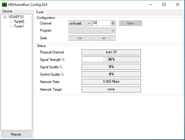

KCJO at it's tower location.
KCJO in downtown St. Joseph, less than a mile from the transmitter location.
