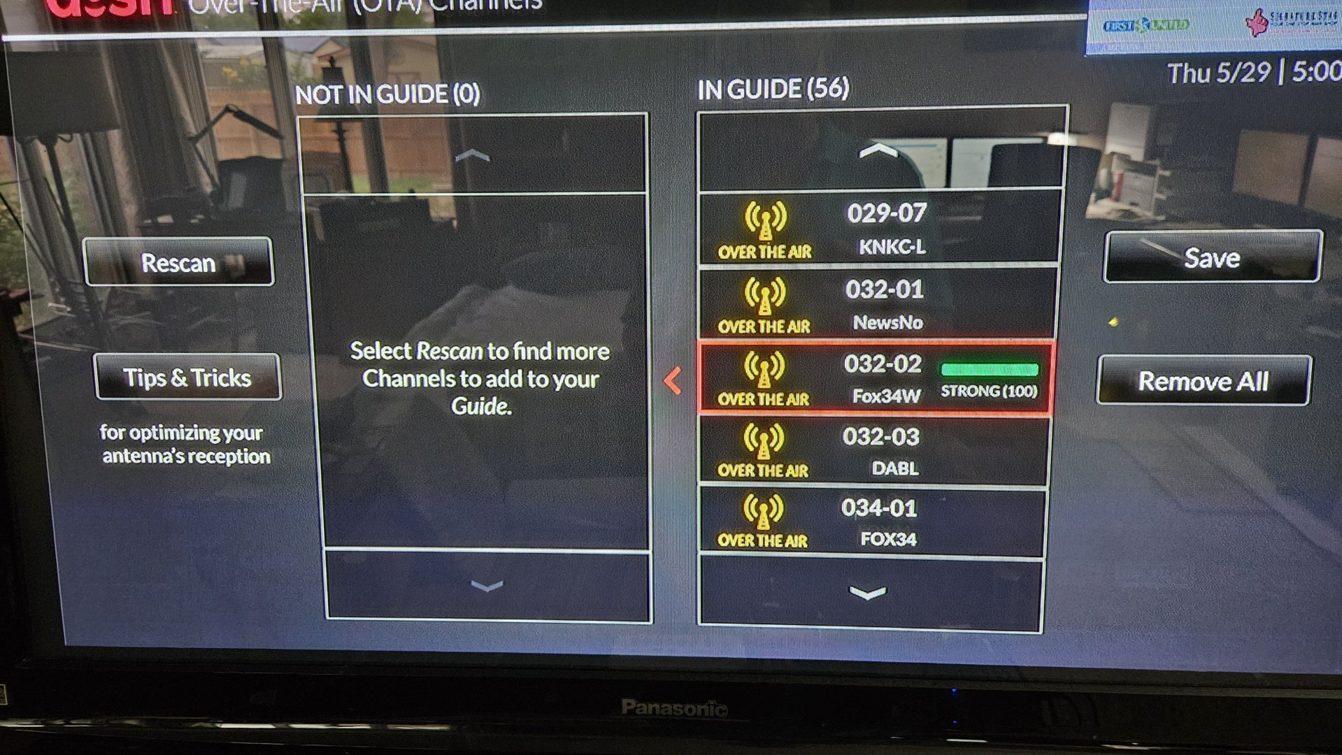

Lubbock Texas channel 32 is acting funny. Broadcasts on RF channel 33 with sub-channels 32-01, 32-02 and 32--03.
Channel 32-03 works fine on my H3 and theoretically the other sub-channels should follow suit.

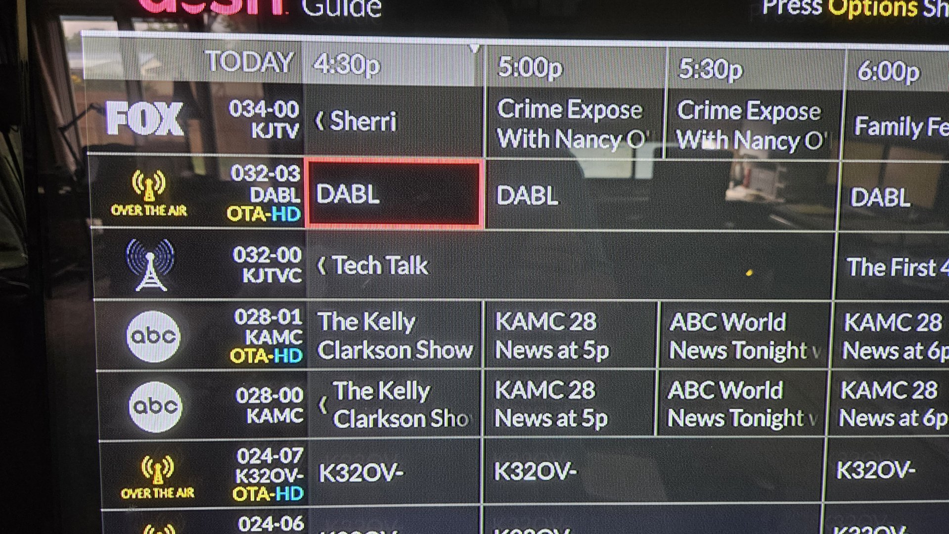

While the H3 finds channels 32-01 and 32-02 on a scan with signal strength 100 on both, and both are listed with the "in Guide" 56 digital channels on the Over-the-Air (OTA) Channels when I go to the Guide they are both missing. I have no favorites lists, so this is the only guide on the H3.
I have deleted the missing channels and re-scanned twice, also rebooted the H3 twice.
I even disconnected the antenna , scanned (no channels found), re attached the antenna, re-scanned - 49 channels found, re-scanned 56 channels found, 32-01, 32-02 and 32-03 all in the in Guide list, SAVE. Go to the guide and only 32-00 and 32-03 are in my guide.

Hopper3 OTA Channels, note 032-01 and 032-02 do not show in my guide but are in the list of OTA channels.
This is my Hopper 3 Guide - the Guide is all subscribed.
