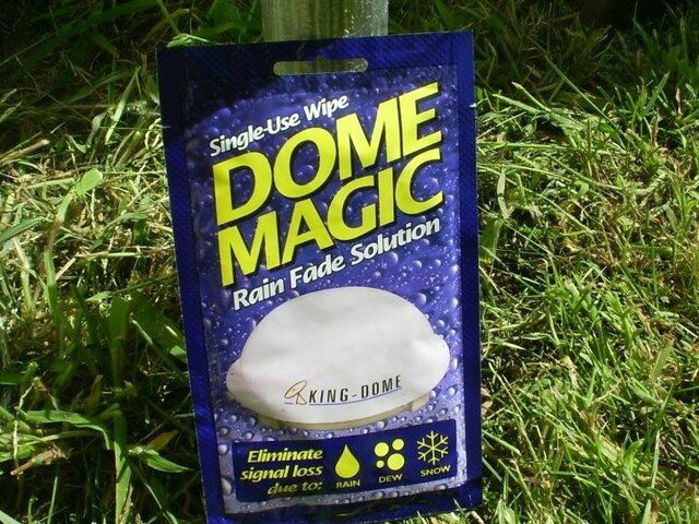

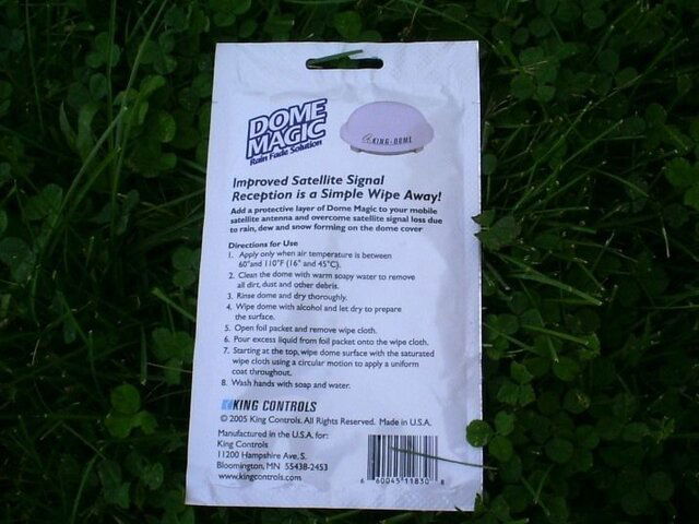

Honestly Tim I am getting as near perfect a solution as will ever be possible by any thing you spray (Or wipe) on your dish!
The product has been improved since you last seen it working! It now works better and stays on the dish longer :)
I am having GREAT success with the new single application wipes. They are SOAKED in Rain Shield and really do add a THICK layer of the product on the dish(LNB)
http://www.kingdom2.com/Accessories.htm
Of course I follow the instructions to the LETTER, making sure to wipe down the dish with alcohol (With a tear in my eye). After spending $ on the product I want to do it RIGHT to get MAXIMUM benefit from it!
At last some Satellite professionals that have ACTUALLY seen Rain Shield in action, I hope its noticed by all that all the negative remarks on this product come from people who have NEVER seen it :)

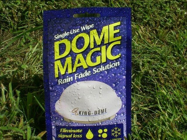

Both have their benefit, the can is the most economic way to apply it :) I sometimes remove the dish reflector and take it into the garage or some other well ventilated area and spray it there. Let it dry then re-bolt the reflector to the dish mount, making sure not to touch the treated area.
Of course its a complete WASTE of time and money using the spray on a windy day. That's whats nice about the wipe, its dripping wet and really coats the surface very thickly. It can be applied in the wind but all other recommendations must be carried out to get the most and longest out of the product!
I would recommend using the wipe mainly on the dish making sure to get the whole surface area soaked, just when its starting to dry out a little I wipe the top half of the rim of the dish then any snow that does manage to land there will be instantly blown away.
I would then wipe the LNB cover and the top half of the LNB casing, and finally wipe down the LNB arm with any remnant product!
Have any spare LNB's handy so that you can give them a wipe down while you are at it!
Should last a year, I had been applying the spray twice a year, once in fall on the last warm day, then in spring on the first warm day.
