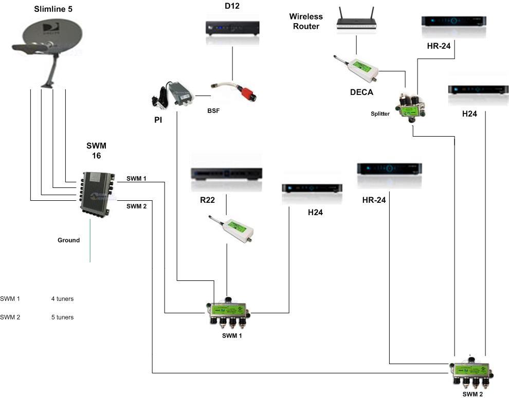

I'm not at all familiar with the SWM/MRV install, so here's some questions and feel free to point me at a FAQ or some such that might be better.
1. Where is the 'block'?
2. and what is it?
3. Since you said 'power inserter', I'm thinking the 'block' has to be somewhere inside the house???
I'm thinking you're right that they wouldn't want to install at the same TV, hence my questions... :)
2. and what is it?
the block as i call it is a splitter looking thing, mines on the outside of the house
the power inserter is in the house and plugs into the wall to provide electricity to the dish
Ah, ok. So they'll be swapping the LNB head at least, maybe even the old dish that's up there - it is about 4 years old and may not be good enough. There are now 2 coax cables coming down from the dish going to the place where the single HR21 was located. I'm going to try to get them to use those over and leave one for further expansion, so hopefully the 'block' will be in a location I can get to (I don't do ladders anymore, nor crawl under the house).
thanks for the info.
heres a diagram i found
and an article link
High Definition Blog » Directv SWM Installation Demystified
Thanks Randall. A good design it appears. Interpolating from that I think this is what I'll end up with and hope for.
Dish -->SWM8(?) --> Splitter --> then One coax to TV1 via a splitter that then goes to the TV and 2nd cable to DECA for the use of the cinema connection kit, another to TV2.
Assuming that is the way things are going to be done, then one cable that is already in place from a previous D* install for TV1 will not be used. I'm thinking that could be hooked to a splitter connection and left dangling inside so I can hook up an additional HR should I want to. Does that sound right? The reason I ask is that on the splitters in all the pictures I see, it shows all the non-used connections having a connector on them, is that connector just a protector for the splitter connection or is it a terminator of some sort?
