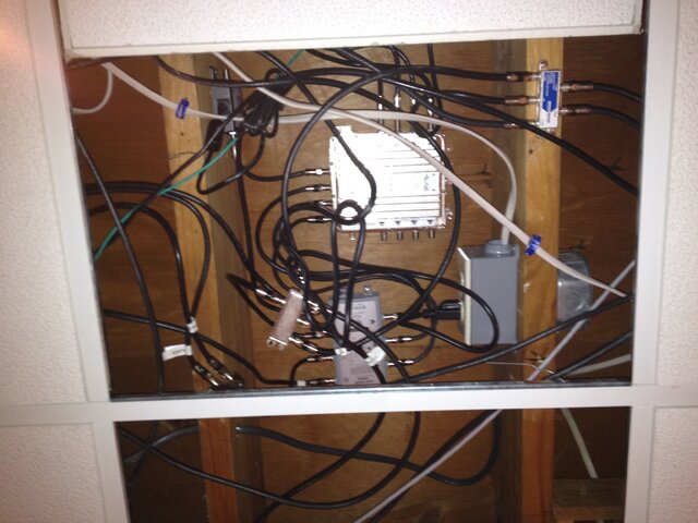

1 Hopper/2 Joeys

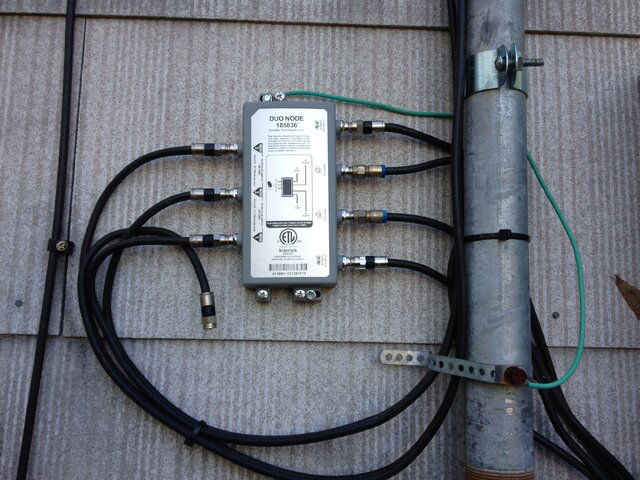

My Setup:
2 lines coming off the Dish to a weather-proof connection box on the house
Into the house to a central distribution panel
Node and splitter mounted inside under distribution panel
All coax is RG6 Quad-shield 3GHz end-to-end
Wall plates are made by Panduit. Coax jack is 3GHz rated.
Install tech was happy when he examined my setup. Basically he only had to mount the node and connect it and then place the Hopper/Joeys/ He had already done a bunch of H/J installs so he knew what he was doing. The whole install only took 90 minutes.

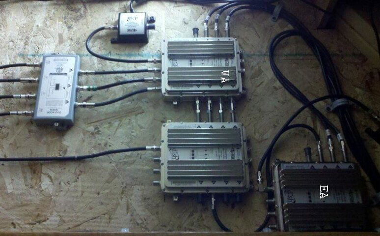

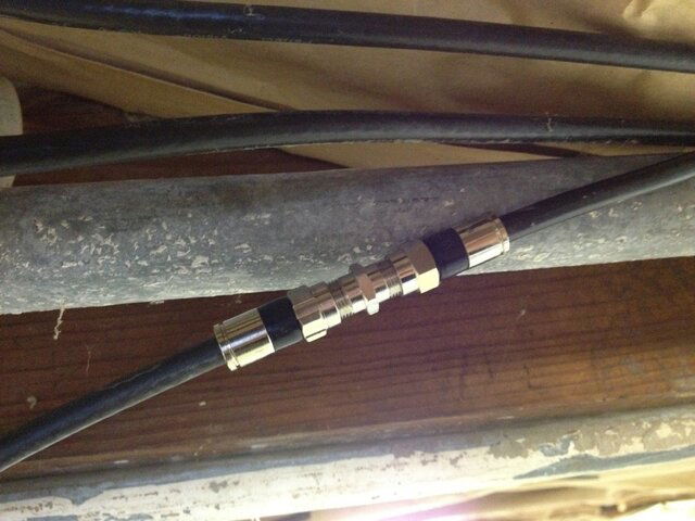

Here is my install. Tech used all existing wire and just barrel connected where old diplexers where. What about my ground wires, I read it needs two? Should I run another one to a grounding rod that is in the ground close by?

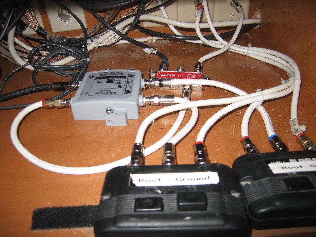

Since this was an RV Trailer installation, space is limited. Also I had to deal with an automatic roof dish and a ground tripod dish for when the roof dish is blocked. I use two high quatity switch to swing the Solo between the rood dish and the ground dish inputs. This is on the bottom of the overhead entrainment cabinet. I use spacers and a finished piece of plywood to cover the cabling.

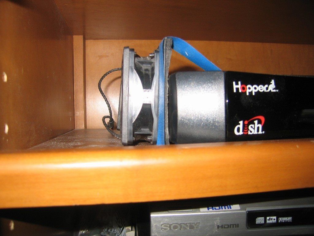

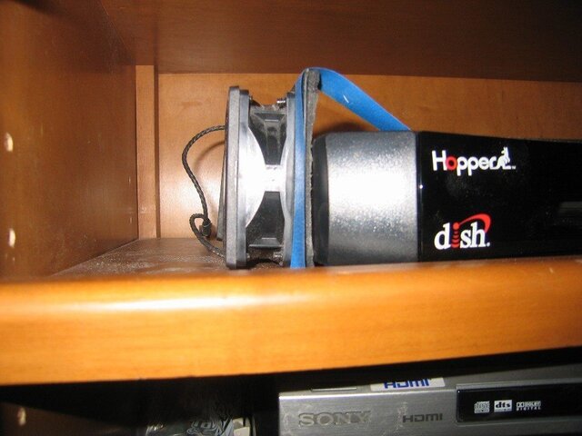

I had fans on the VIP722K. I used blue masking tape to secure the fans to the end of the Hopper. Than worked for two years when the VIP722K replaced the VIP622 and the attaching foam tape didn't come off.

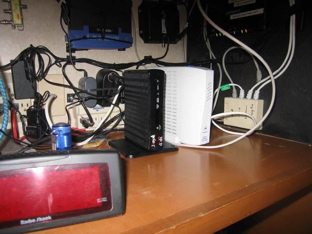

One of the Joeys is located behind the bedroom TV. Because of the space when the tube TV was replaced and the proximity of antennas, this space is also the Wi-Fi center with the routers, and the wireless amplifier. The Joey is standing next to the cable modem that we use when in Texas. It was no problem for a cable Ethernet connection for the Hopper and this Joey. The second Joey uses a wireless bridge for Ethernet.
What's with the loose hanging coax?
I have been looking for a box like the first one (weatherproof) for ages. I was looking for info about it, but I only found one type of coax module for it it doesn't say anything about 3ghz anywhere so I don't know if it will work for what I want to do. The switch is outside so I need the output from the switches to go to this box (Antenna->switch->weatherproof box)
Looks like that coax is in a severe bind with the door closed. I wouldn't want one of those.
