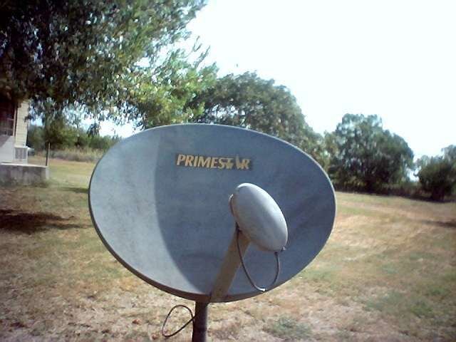

well i can't find anything with the round dish
went back to the oval dish mounted in a 5 gal bucket and hit ia6 and then ia5 with no problem

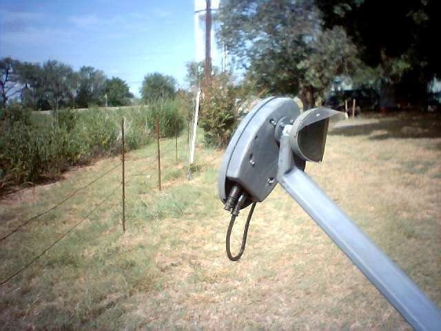

might have to swap out the lnb on the round to see if its bad most likely i'm just no good at aimimg the big round dish . lol
hope everyones having a great weekend
gabshere said:
the skew didn't seem to add much it maybe went up a %
Hi! When skewing these LNBFs that are made for the wide ellipticals shaped like Primestar (and WorldDirect) the feedhorn assembly must also be skewed, but much better to skew the whole reflector. Here's why: look inside the clear plastic and you might see some stair-step patterns--those help to reject adjacent signals and if you don't also skew them then they also reject the illumination you want!
In any case you should also figure out a way to skew the reflector, too, since that special stair-step pattern is intended to use the whole wide oval reflector and skewing it will still miss much of the illumination.
