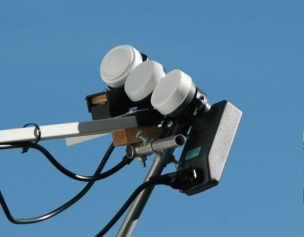

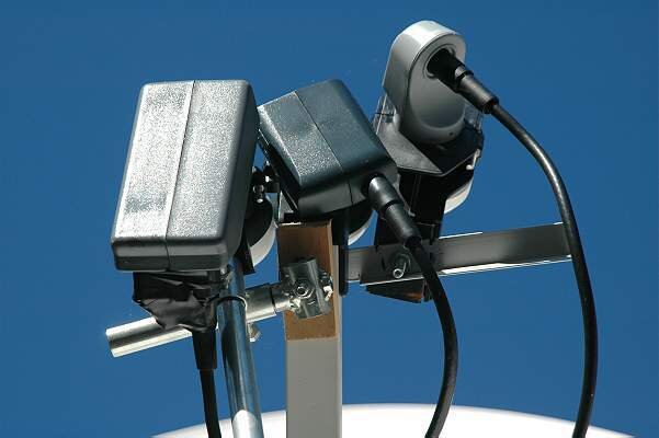

WyldCherry said:I am aiming from the ground.had it above the lnb arm.I have a 3 lnb bracket I even tried like all the pictures put a piece of wood in between the lnbs and hose clamped them had the one for IA-7 a litlle higher than the one on G10R tried it higher then kept coming down real slow.just couldn't lock on to it.I had to manually add that satellite to my menu it wasn't there and I used the TP for White Springs 11989 is this correct for the SR 2821?
WyldCherry said:hmm well I used a 2 inch piece of wood as a spacer then a hose clamp.my lnb was a little higher than yours.it may be I can't get it at all.have a mountain about 1 1/2 miles away I am trying to aim over
