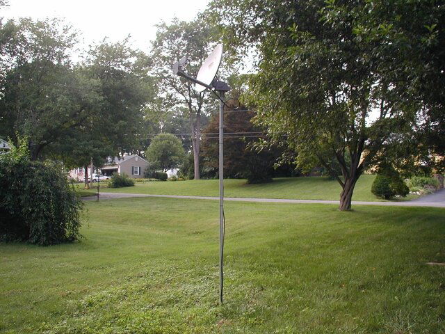

Any installers know the NEC code for grounding a pole mount? Halsted came out Monday to ground my dish. They said because it went into the ground three feet that it was sufficiently grounded and didn't need a separate ground! I don't think that's correct. The NEC code 810 says something about needing a separate ground even for a pole mount. Anyone have any specific knowledge about this type of situation?

The pole isn't painted, it's galvanized. Here is a picture of the install. It will need guy wires, but even in moderate wind it is stable.

I put up the pole myself. It is three feet in the ground and nine feet above. I wanted to go four feet down, but I hit ground water. There wasn't much I could do about it, unless I wanted to wait several weeks for the water to go down. Spring in CT can be very wet, especially when you have wetlands behind your house! I will need to put up guy wires, but so far I have had no reception issues due to the pole being so high.

that thing is WAY too high off the ground on a pole...even guy wires wont stabilize it from twisting in the wind.
the max above ground for a pole of that size is (i think) 5 feet.
still need to ground it and bond that to the hosue ground (like I and 5 others said)
is there any way for you to cut that pole....like in half and go there?
Also keep in mind if you guy it youll have to mow around it freaking all the time....trust me it gets old... Im had an outdoor antenna guyed in 4 directions... it was a pain to mow around... now my issue is the 2 trees i planted this year i have to mow around those things.
also did you put the pole in concrete? if so did you put anything through the pole to keep it from spinning.

Mowing around it and a set of guy wires isn't an issue. I have a 45 ft tower for my c-band dish that has three guy wires on it.
There is 80 lbs of concrete in the ground and yes there is a large bolt through the pole to keep it from twisting.
It's that high because I have los issues. It could be a bit shorter, maybe a couple of feet, but in a few years it would be an issue again.

if its sch 40 it will be fine.

It's sch 20. I wanted to get 40, but the place was out of it. :(
