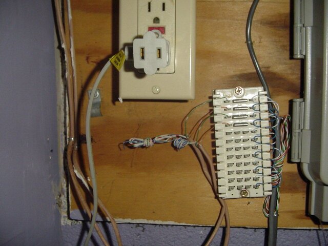

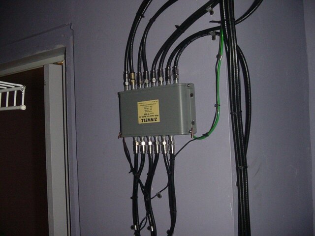

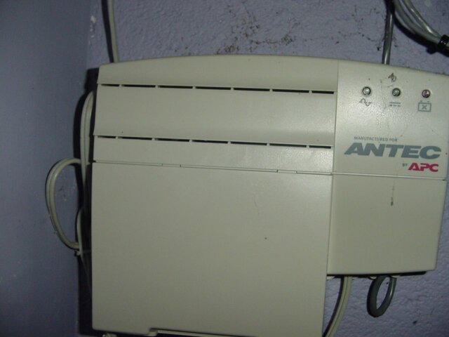

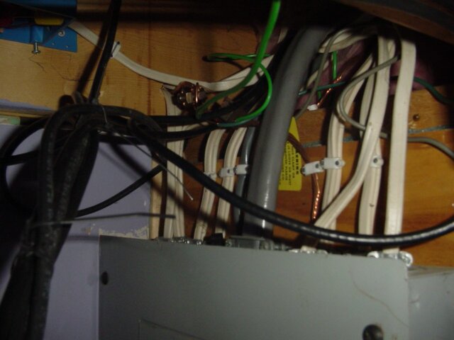

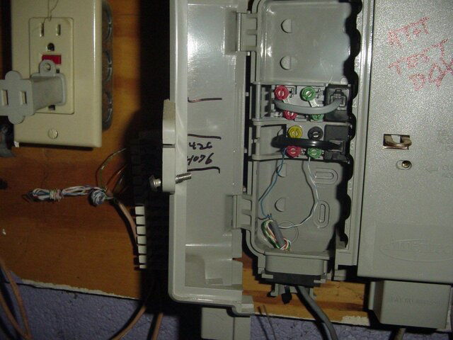

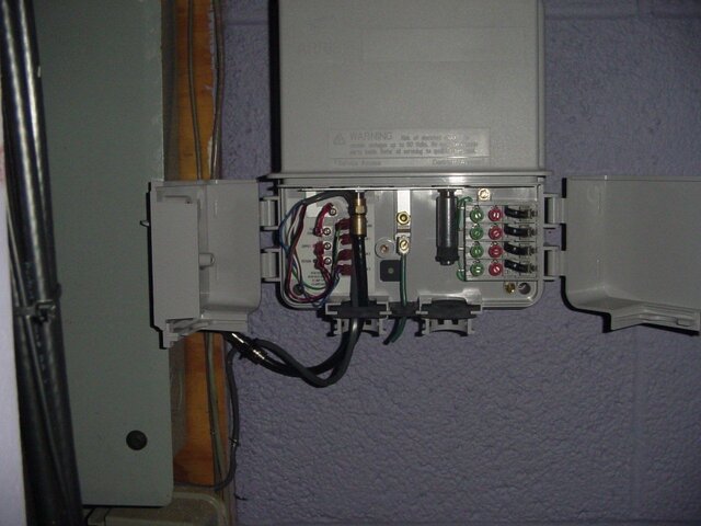

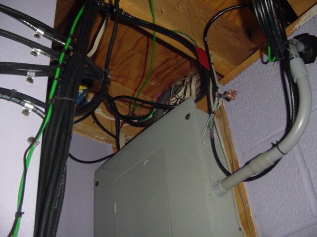

My city must be different than where I lived before because Comcast SBC and D* all put their ground blocks and clamps INSIDE the house. In fact the network telephone interface is inside the house. The cable ground block is inside, the cable telephone interface is inside and the punchdown block is inside. All the phone equipment is run with a UPS unit. The pictures should make sense.
