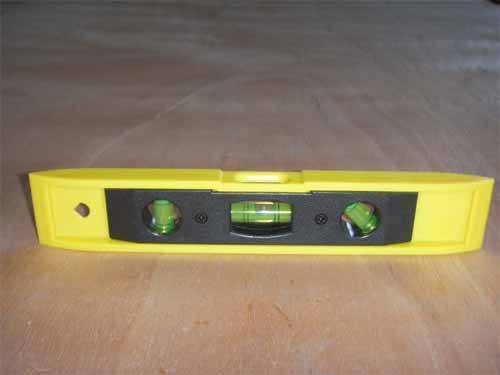

I have a level like the one in the picture above. It has a magnet along the side. The magnet sticks to the side of the pole. I put the level along the back of the pole to check if it's plumb, and I put the level along the side to check if it's plumb. If the bubble is anywhere near the center when you check each side, you should be okay.
