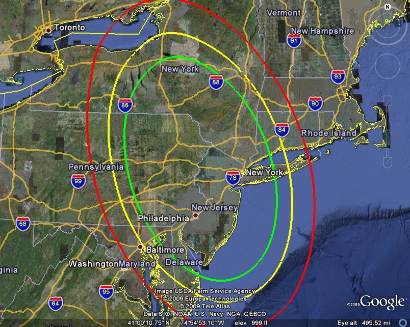

HD Locals, That's what my friends have with Direct.... I found a map on here with the dish spotbeams on the 61.5w which i am on.. I'm right by the A in Delaware (Location wise) E12_SB3.jpg
If you are by the "A", you should be boarderline on the spot, I would think you would get the HD locals, buy you may need to have the highest signal strength to maintain the signal since they do drop quickly. Usually a bigger dish helps with the signal.

please note the maps on 61.5 can be (and usually are) wrong. Dish shifted the spotbeams a little bit

no you are out of the spotbeam for NY
61.5 TP15 is used in your area for Norfolk, VA. Read the post above yours (click on the link). A guy in Sussex County who asked the same thing. Since transponders are reused in your area you would get Norfolk, VA locals instead of NY. You are out of the NY spotbeam (again Dish shifted some spotbeams so the maps are wrong. The NY one included)
