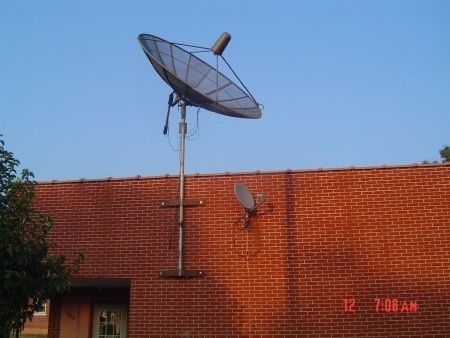

I had this mount built by a local pipe and steel company.
It is constructed out of 3" shedule 80 well casing with plates 5' apart for holes drilled through a 12" block and brick wall and plates on the inside to help hold it. The top 12" has a 3.5" section slipped over the 3" pipe so the cap would fit snugly. The bottom is about 8' or 9' off the ground and tops out at about 22' at the cap where the BUD sits. The mount alone weighed about 150 Lbs when we put it up.
They only charged me $130.00 for the steel and welding it together. I drew up the plans, and took it in and they bid it on the spot for me, and I picked it up a week later.
The owner used to be a client of mine back when I sold welding supplies and industrial gases, but I don't think that had anything to do with how much he charged me. I am sure he made a little money on it.
Here is a picture that shows it a little more clearly. It is the same as my avatar, but this picture is bigger. from-west-side-view.jpg
Hope it gives you some ideas.
Fred
Great idea there. You have a simple roof without an overhang. Unfortunately, I have a roof with an overhang that protrudes about a foot past the concrete wall. I'll keep any eye out for parts. Thanks.
