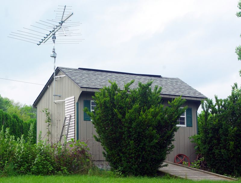

Now that the dust has pretty much settled with the repack I guess it's time to throw in the towel. Prior to the repack I could receive 16, 22, 28, 44, and 56 (and all their subs) out of Scranton/Wilkes-Barre/Hazelton PA. As each channel was repacked I lost it with the end result today that I no longer receive any of them. They are all gone for me. My location is considered to be demographically in the SWB market yet I can no longer receive any of their signals. However, I have scanned and locked 68 channels out of Phialdelphia/Delaware even though they are much farther away and there is a mountain between me and them. Yep, makes sense to me. Thanks for nothing FCC. :mad:

If it was Tropo it worked well for 15 years until the repack. I've been scanning weekly for more than a year and no luck. Each station disappeared as it was repacked. When the rescan notice came for each and I rescanned it was gone. I've been in contact with station engineers and there doesn't seem to be any real concern.
Rabbitears is not, in my opinion, accurate. It lists every Philadelphia station as "Bad" and I get them all clear as a bell and always have while SWB is listed as "Poor" and I lost all of them so Bad is good and Poor is bad. According to Rabbitears I should not be able to receive any stations yet I regularly scan and lock 68 of them, all from the Philly area, except for the Allentown stations which I also receive..

Radio Shack VU-190-XR Antenna
Channel Master 7777 mast mounted Pre-Amp
I think it's entirely possible that this pre-amp is causing your issues. I can't use one in my area, because even a single strong channel can swamp it in odd ways.
I switched to a Televes 560383, and pretty much solved my issues.
As an antenna installer, I have seen many of the old 7777's that the switches inside went bad/noisy. You can try either cleaning them with some Deoxit, but the real fix is to take the preamp apart, remove the switches, and solder jumpers to the positions you want. Not sure why you are getting Phila, and nothing on WB. The other thing that can be happening, is you have a cell signal in the 700Mhz band that is overloading the preamp. You could try one of the new 600 mhz low-pass filter on the input from the antenna. I am 77 miles from Penobscot Knob where the WB signals are. They are also our local channels, but over the repack our 16, 44, and 56 have gotten better due to the lower rf channel they are using. I get a -18 db barefoot (no preamp) here on 16 and 56.
