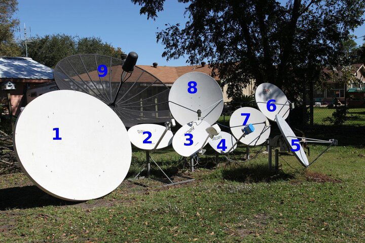

I will post details and plenty of high quality, professional grade photographs. You guys have seen all the dishes I have and I'll be adding more dishes before too much longer.
I have some really weird and complex switch and motor setups which are probably a bit beyond what a lot of people would normally have so we'll get to see how it handles
