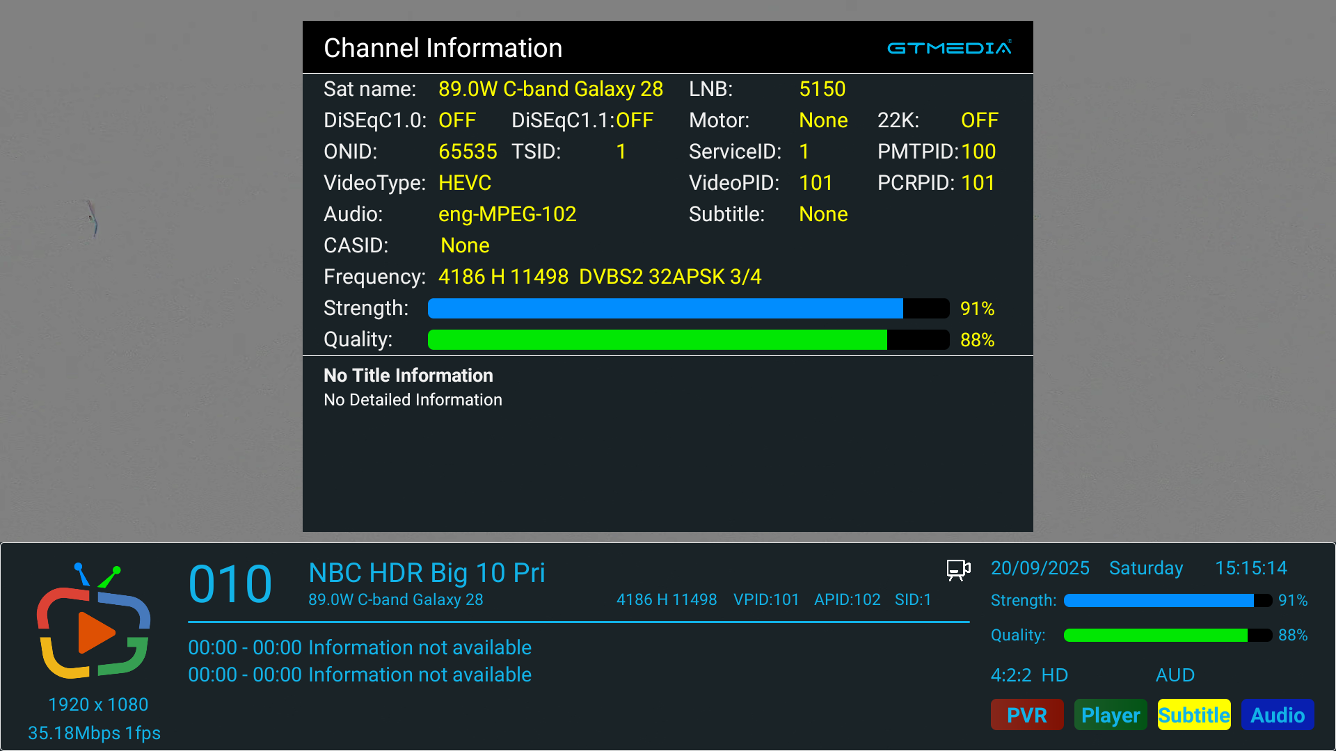

The big selling point for this receiver is its purported ability to natively decode and display 4:2:2 feeds, which it does. HOWEVER, depending on the signal modulation, the output quality varies. For instance, a DVB-S2 h264 4:2:2 signal plays just fine with no buffering or breakups, but a DVB-S2 HEVC 32APSK 4:2:2 feed displays some stuttering and drop-out's. The box really struggled with the ABC DVB-S2X feeds.

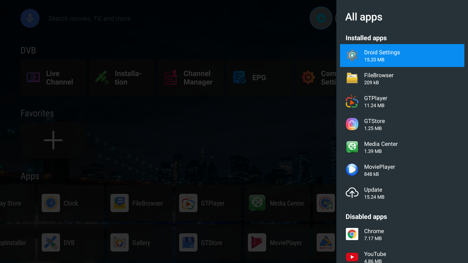

I highly recommend disabling any Android bloatware that comes with the box including Youtube and Netflix, as it slows down performance.

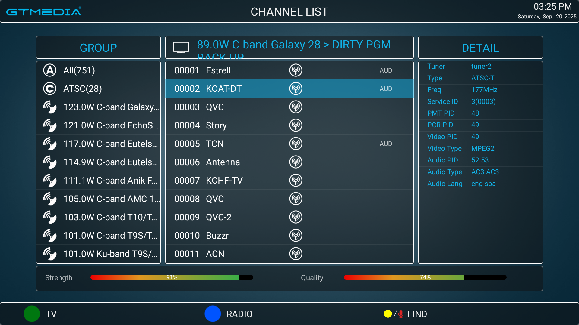

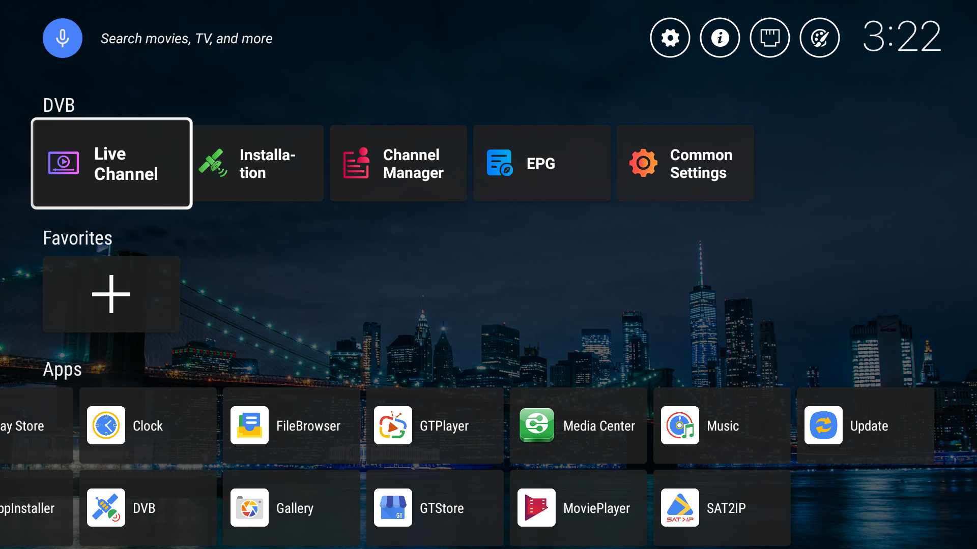

The menus take some getting used to and you will need to make adjustments in order to display channel lists the way you're used to.

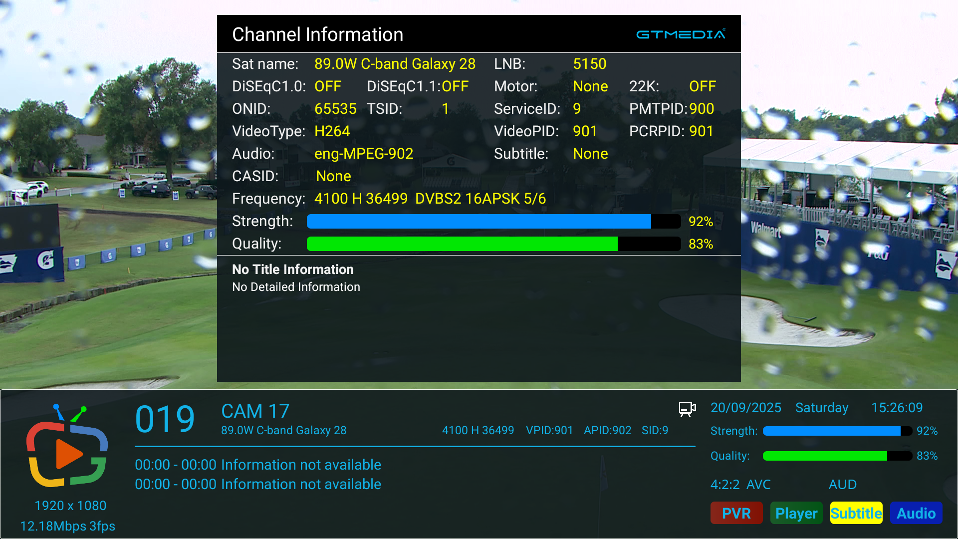

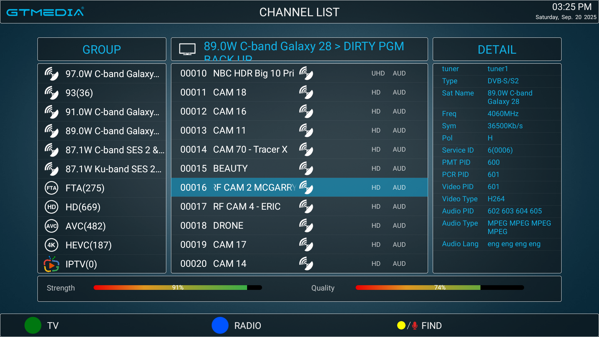

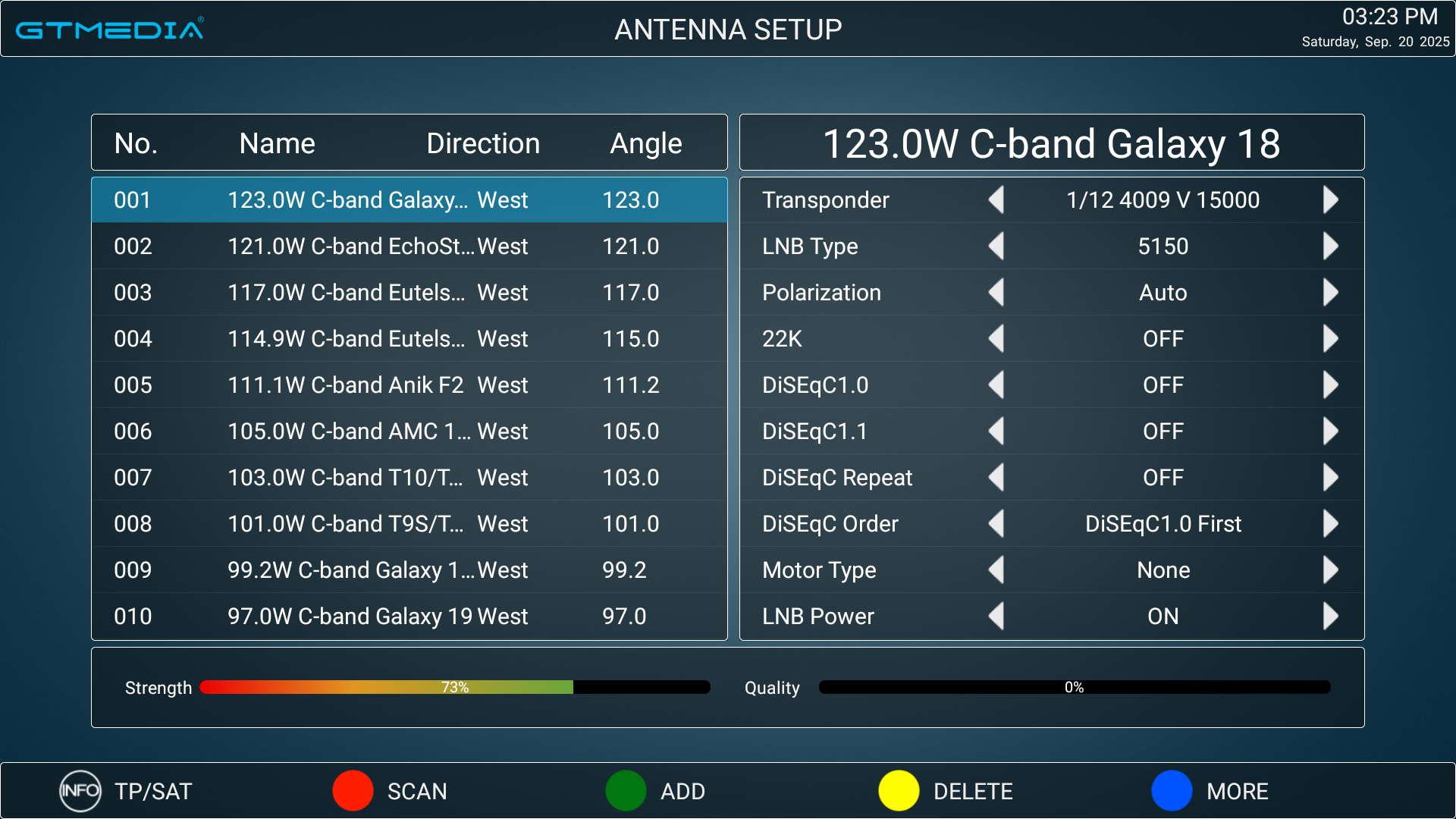

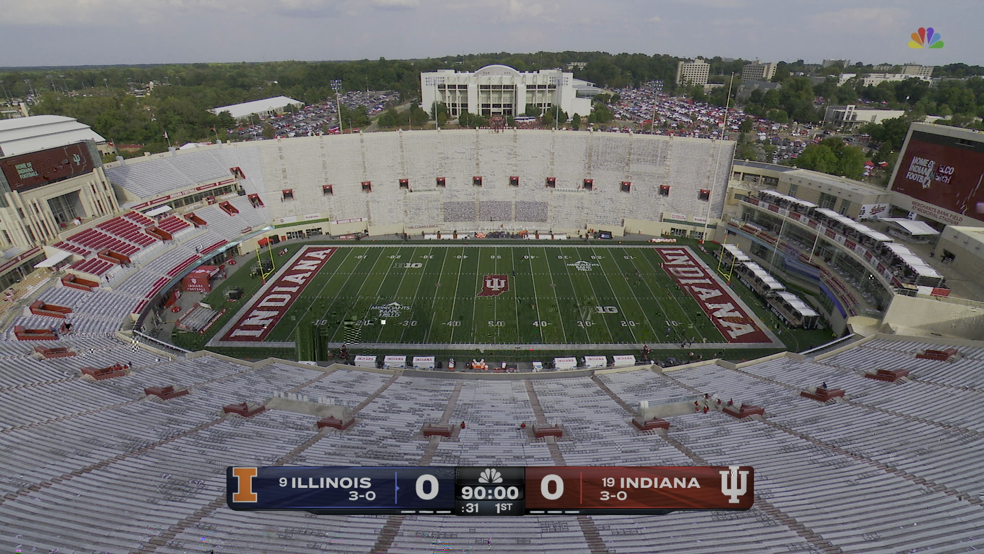

Here are some screenshots (push and hold the Power button to take screenshots, like other Android boxes). I really like the way the unit displays signal modulation properties and bitrates.
