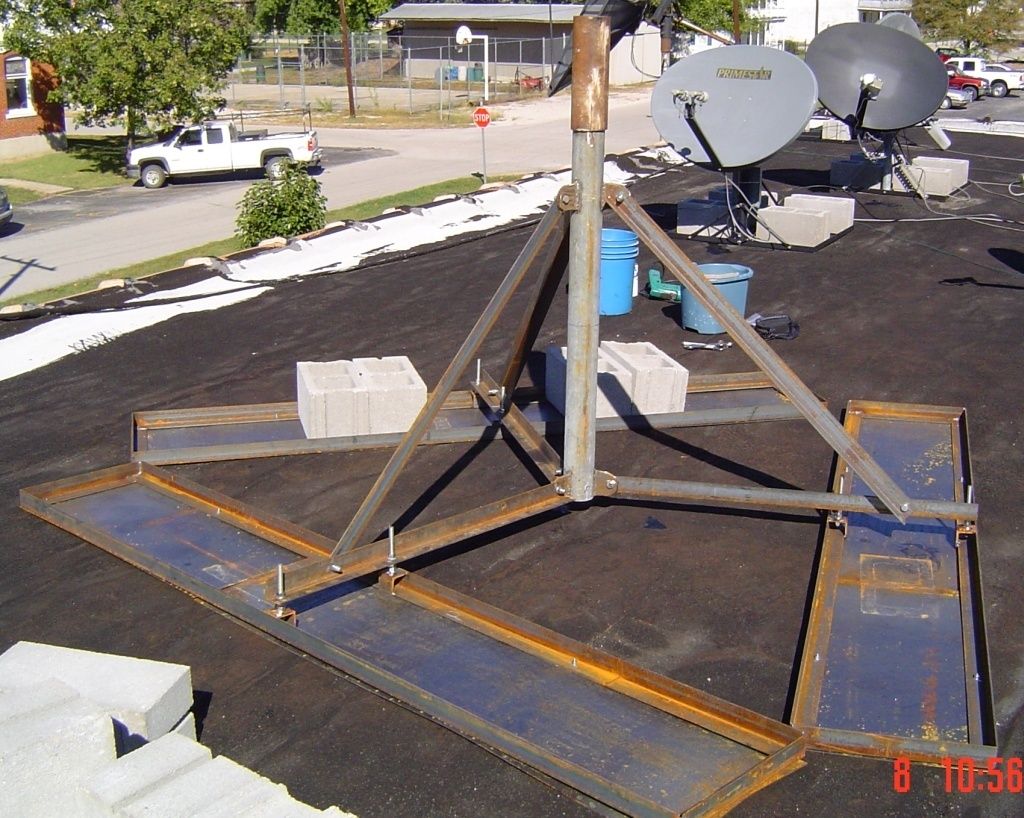

The antenna mounted low in the pic, is that the one that gave you trouble a while back?
Don't have the specs for that one.
Caddata was in the process of making a drawing with specs and materials list of the roof mount that I use, but he has dropped off the map somehow.
I haven't heard from him in 2 or three months at least.
I have tried to contact him by PM and e-mail, but as yet no response.
Hope nothing has happened to him.
Here is what I use:
Keep in mind that the mount itself weighs a couple of hundred pounds, and I put 500 pounds of concrete blocks on each out-rigger for ballast.
Works fine for my dishes, but you need a roof that will support that kind of weight.
