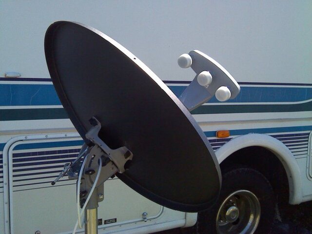

There is a western arc LNBF made specifically for the 1000.4. I have both arc LNBF's for my 1000.4 and switch as needed depending on my location and/or aiming needs.
Here's my 1000.4 with the western arc LNBF installed:
Reactions: charlesrshell
Thanks. Is it called 1000.5?
I haven't seen it labeled that way, but I bought it as an eastern arc 1000.4 and just added the western arc LNBF to the order. Both LNBF boxes were labeled for the 1000.4. The 1000.2 is commonly used for either arc LNBF with the same dish number though, so I never gave it a thought until you mentioned it.
