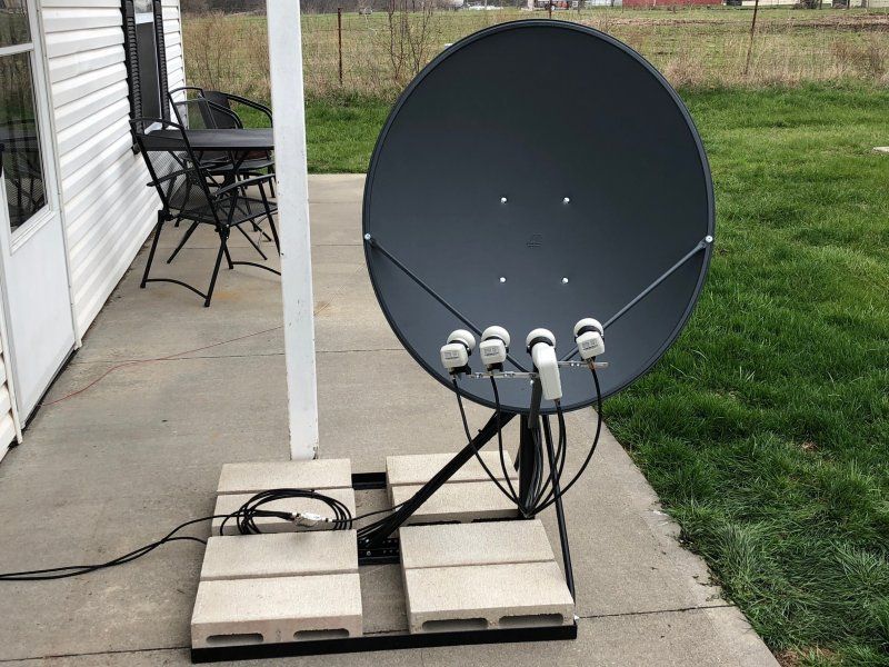

Some of you are making the mistake taking an FCC regulation that governs the placement and and only the placement of an antenna to what the HOA has legal authority to do regarding balconies, to regulate the structure, meaning regulate the attachment of that antenna.
AGAIN Claude hit it - if the HOA insists on no drilling and unless you know and can prove that is not the law or in the legal documents you signed you have to use a mount with weights or whatever clever way you can to install the antenna. I posted and then an actual document echoing what I said was posted of how you may be able to get it installed with drilling holes. But it's often up to the HOA, nothing new.

In most condos, all exterior walls and attachments are maintained by the association, thus they have the right to refuse you making any modifications (attaching antennas, drilling holes, changing light fixtures, etc.) to anything they are responsible for which could be a liability to them in the future.
You may place a non-penetrating dish platform on the patio, but you may not be able to attach it or drill holes to run your wires through the wall into the condo.

This is the one I use. You can likely find it cheaper on Amazon or Ebay. The mast is reversible with 2 sizes. Satellite AV, LLC - Satellite Broadcaster Support and Equipment Distribution
Here's a picture of mine:
