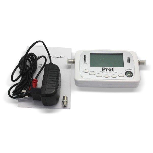

Yes I did, but i haven't had a chance to use it yet. I'm re-doing my c-band dish, so should get that chance later this week. It has a Russian user manual it came with! However, I got an English one emailed to me from an Australian user. It also came with a European 100-220 volt 50 - 60Hz adapter, with those odd round prongs/plug on it, and no adapter to change the prongs for the US. However, you can power it from your receiver inline through coax, or use one of those dual 9 volt battery adapter plugs. I ordered an American power adapter plug from Ebay for like $2.00, just to have one.
It only took 2 days to get from China to New York, and then 10 days to get from New York to Mid-Michigan! Go figure...

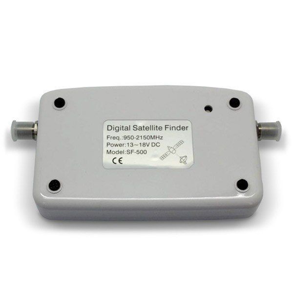

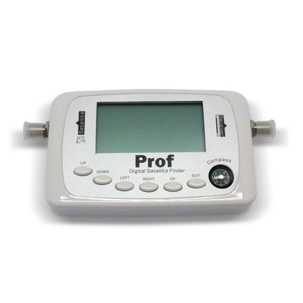

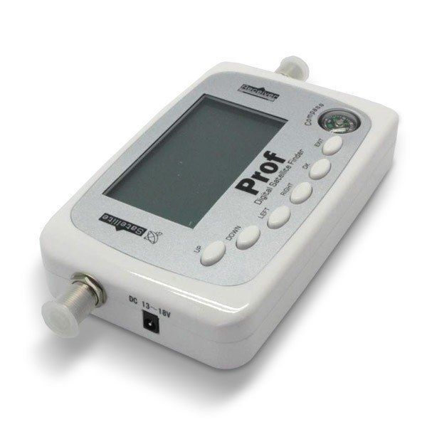

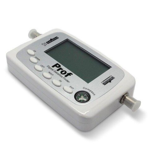

Here are some preliminary pics. click on one and it'll open as larger into a photo layout:
prof-digital-satellite-finder-sf-500-1.jpg prof digital satellite finder sf500 2.jpg prof-digital-satellite-finder-sf-500.jpg
prof-digital-satellite-finder-sf-500.jpg prof-digital-satellite-finder-sf-500.jpg prof-digital-satellite-finder-sf-500.jpg
This is the same meter, just repackaged by a US reseller for quite a bit higher price:

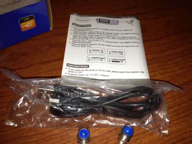

FedEx ground guy was here bright and early.

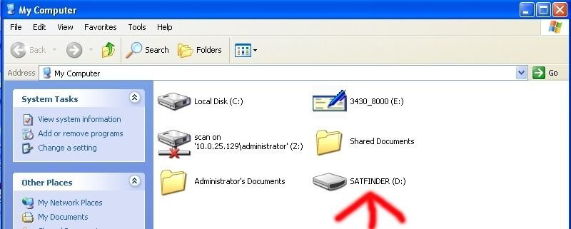

Software update is like pie in the sky.
1- You plug usb cable into computer and meter.
2- Meter comes up as a drive letter.
3- you copy .bin or .xls file over
4- unplug usb cable from meter.
5- That's it your done

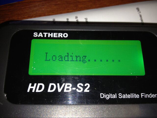

Yes sir. On the road tonight so I only had about 30 mins of testing so far it's looking good.
Meter is working good so far only about 3 hours playing with it.
I had to call the tech line (BOO) because I could not find the sathero.exe after about 10 mins on the phone I found the file myself in the SH-500G_V20120825-sw.zip file so I suggested perhaps they list it under the SH-100HD section. (That makes sense to me :confused:) "sathero.exe is used to convert .xls to file that you drag and drop"

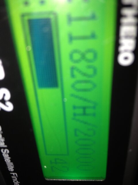

I was able to line up SES 1 TPG no problem very easy. Will post more in next few days.
Try some DVBS-2 signals and let me know how it works.
