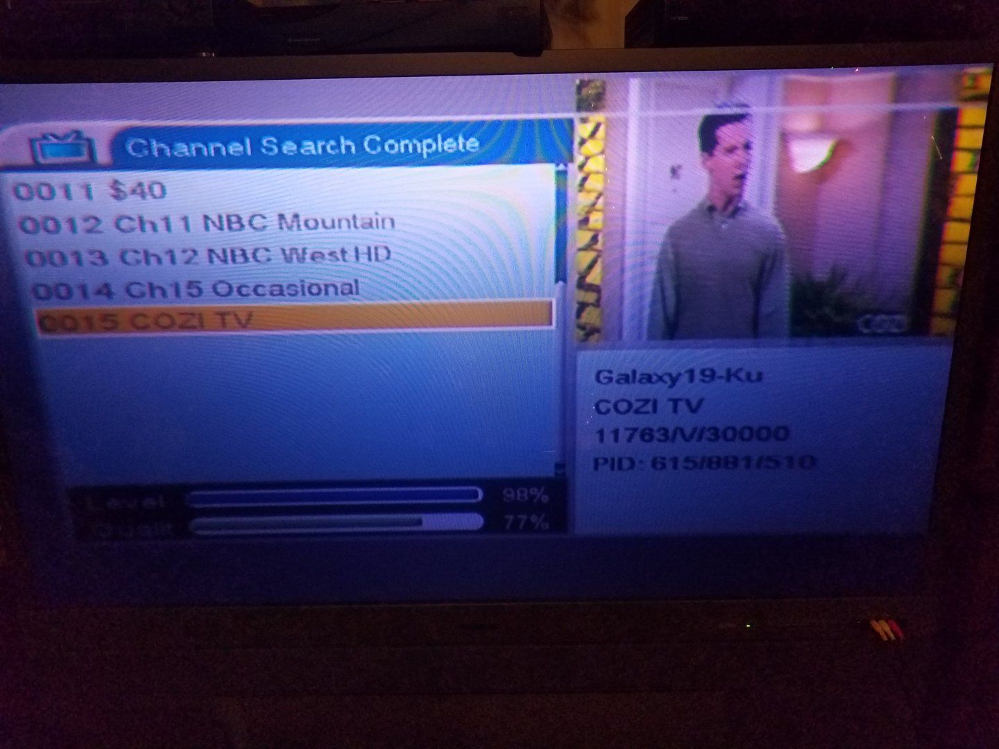

After setting up the Invacom Quad QPH-031 I got a few channels. Look at the picture below. It is pretty obvious what I need to do, but it's raining. (The dish is pointing at SES 3 at 103.0°W instead of Galaxy 19 at 97.0°W ) I need to turn the dish a little to the east and slightly raise the elevation.
