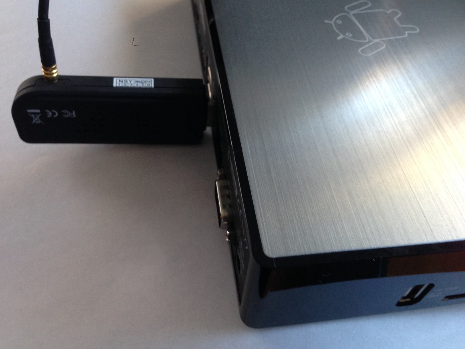

I bought one B's things during the show as well!! I also got this on BF which should work with the APP Hopefully.
www.newegg.com/Product/Product.aspx?Item=0EJ-0019-00005
You will need an adapter... :D USB OTG Cable This is the one I purchased: http://www.ebay.com/itm/231080991051
It works well, but I clipped the LED and IR sensor to lower current demands. Not sure that it was necessary, but it seemed to reduce reported hardware errors.
