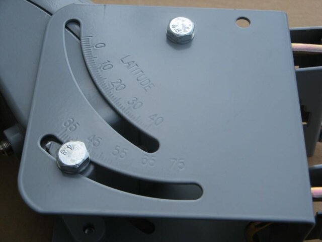

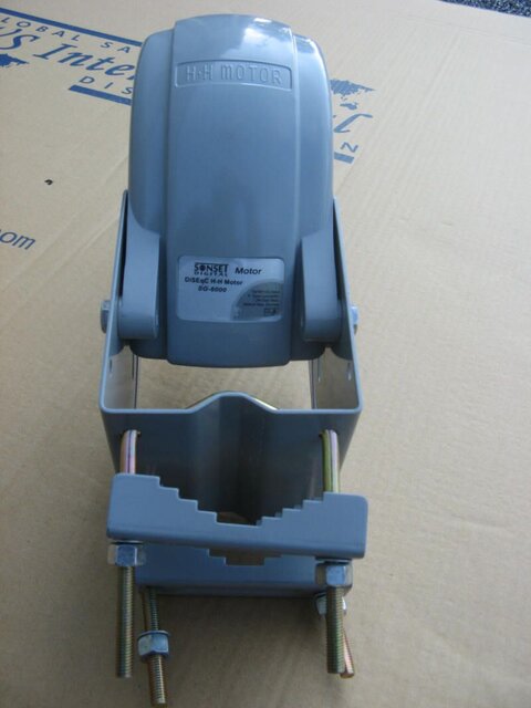

SG6000 Motor Pictures
Here is some pictures of the bracket of the SG6000 HH satellite motor. You can see that the latitude goes from 0 to 75 degrees.
The design of the back bracket allows it fit any pole snug. :up
