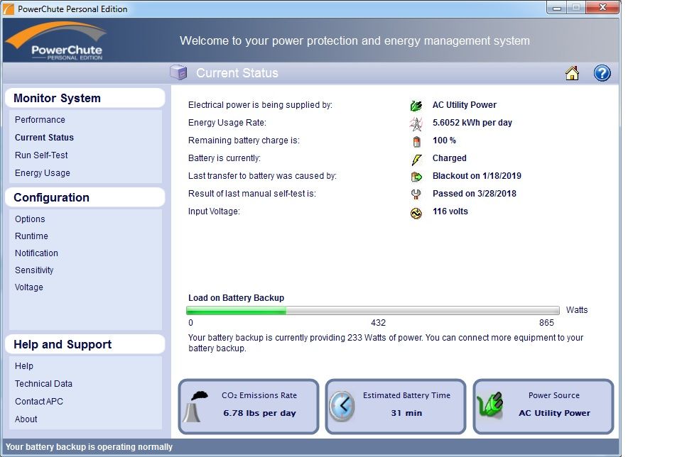

I have two 1500VA APC Computer backups. I plug all the stuff into them. I can monitor them with the PC. This is a screen shot of the PC and satellite backup program.

The snake in the grass with UPSes is that they are typically rated much higher than the load they can support. Along with a 1,500VA rating you also see a 900W rating. That's a pretty big gap (and why the load scale in the UPS status screen only goes to 900 Watts).
Using Magic Static's UPS as an example, it will run for about 31 minutes with a 233 watt load but it will likely shut down (and probably not restart) with a 1,000 watt load (a modern microwave or electric pressure cooker). UPSes are designed to keep things running until you have time to shut everything down normally.
If all you need to keep up is a small TV (100w) and a refrigerator (65W), a large UPS would work for perhaps 40 minutes.
