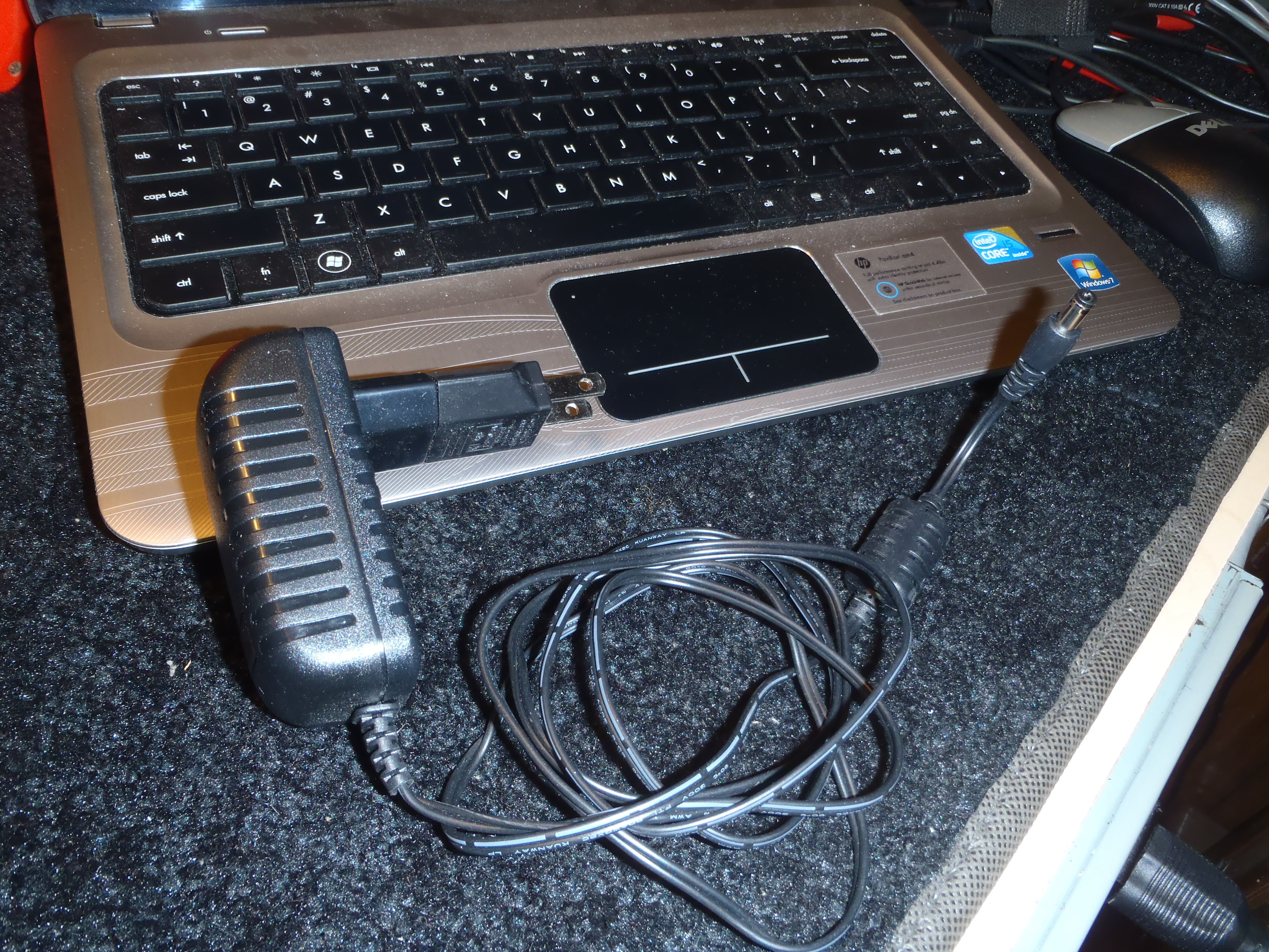

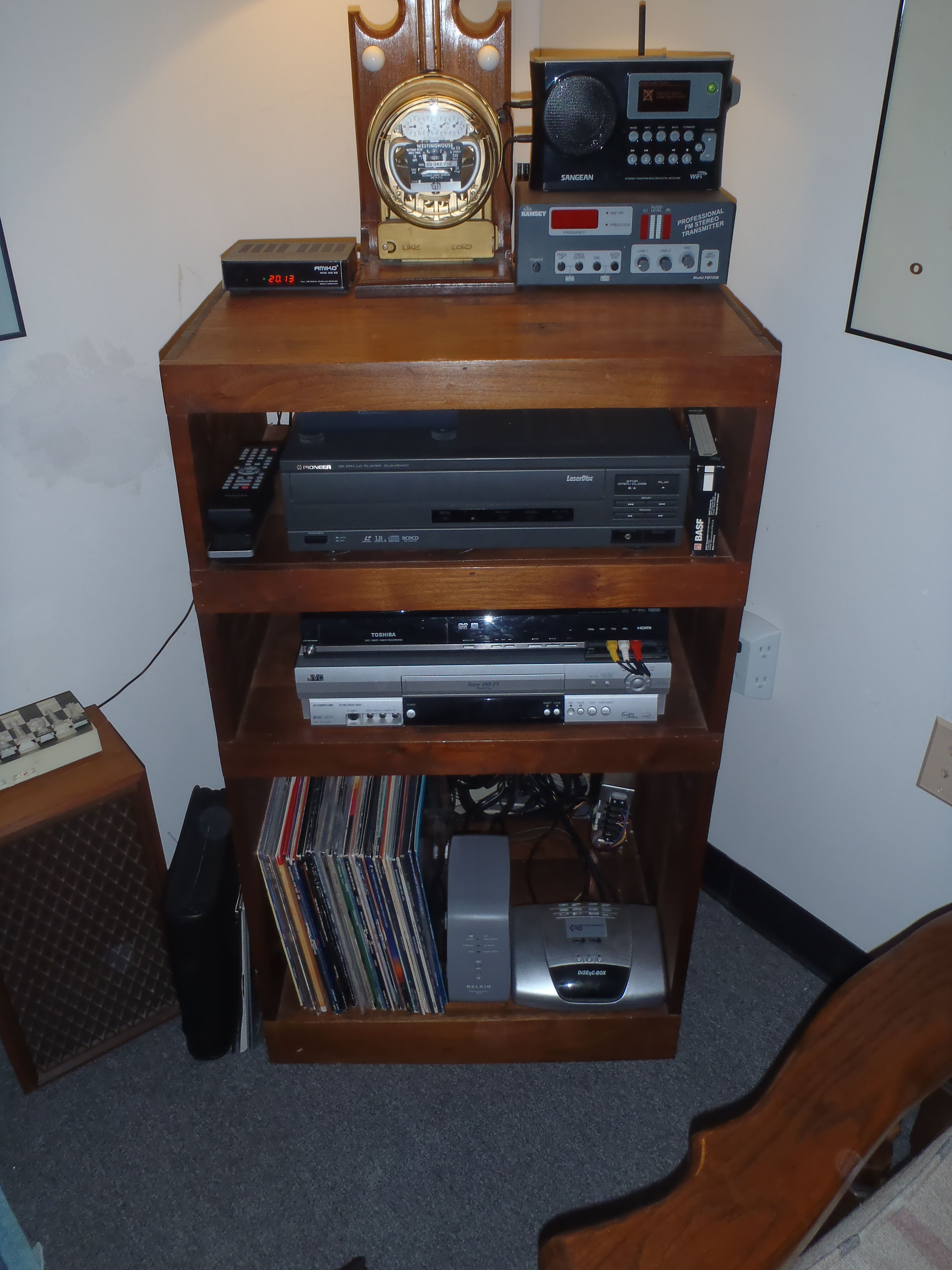

Deployed! And, the first picture with UPS in bottom of rack sure beats the heck out of the ugly "adapted/original" wall wart sticking out so far in the outlet you see to the right of the rack. The plug and polarity are perfect for both the MicroHD and the Amiko MiniHD
