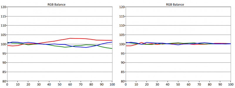

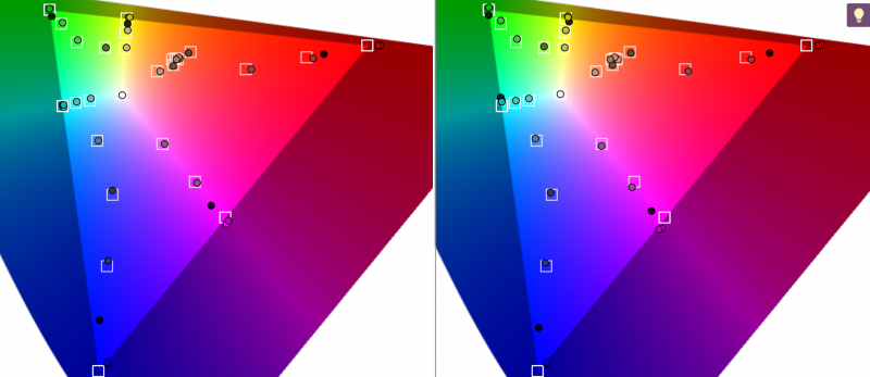

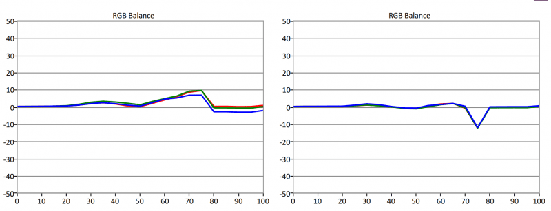

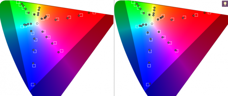

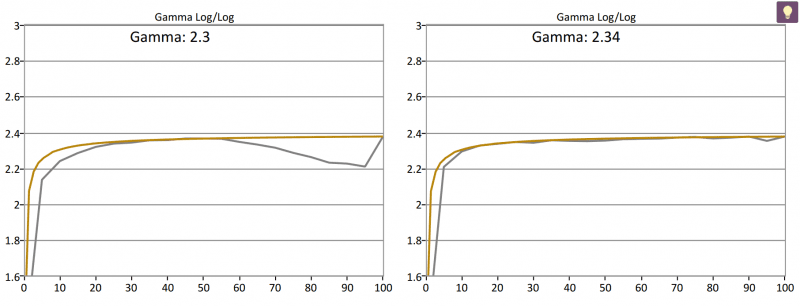

This was by far the easiest cal I ever did. I followed calibrator recommendations, reset Cinema Pro to stock, adjusted the backlight to where I wanted it (had 15 which I knew was too bright) at 10, which was 45 footlamberts. Since I don't use day/night, I have been using around 45fL for a few years as my all the time mode.
Black level at 50 was perfect in both SDR and HDR, left Contrast at 90. I knew the image was very blue, and the pre results showed that, looks a lot better now in the brighter scenes (you could see a purplish blue around people against a sky, etc...).
As far as white balance, all I had to do is RGB High, to get the 80% looking pretty nice, and then when I ran the full thing, the results were under two so I left it alone. I've learned not to obsess, and I did not even touch the 10pt.
What I love is once you trigger HDR Cinema Pro, the WB adjustments are carried over, the the results are great. Sony's decision to take the SDR WB and map to HDR was brilliant IMO, I wish more would have done that. I also hope they follow the same suit with Dolby Vision, because not many can really calibrate it yet.

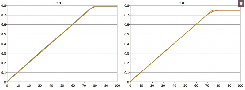

With 10% or larger patterns, HDR nits were lower as you can see. With a 5% pattern it hit 1200 nits. I think in reviews the folks hitting over 1300 used 2%.

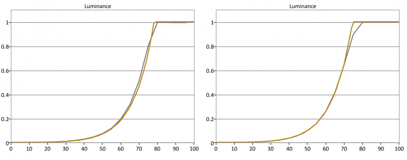

Well, Chad B finished up today with an SDR, HDR and audio cal. Took about 5.5 hours. Will post charts for HDR and SDR.
Some bits:
  • The SDR cal I did in Cinema Pro with my Calman setup was pretty dang good and about what I expected. Chad has better stuff and used 10pt and dialed SDR home in Cinema Pro. As I found, if you flip over to HDR and use the SDR white balance settings, it maps over pretty good but he did a separate pic mode for HDR to really dial it in.
  • Put up a pattern with a small zero black box in middle and white everywhere else, MLL was 0.001 fL (better than a VT60) and contrast ratio was 48k to 1, the thing is a beast.
  • Got her dialed in for HDR mode, taught me a few tricks for settings to get the most out of the mode, stuff I never would have thought of. As always great service.
  • SDR info below. He sacrificed a little on the gamut to get better color checker results, mainly for fleshtones. Keep in mind the before White Balance is pretty good because that is after I used my meter, when I did it, it was real blue.
HDR EOTF.png HDR Gamut.png HDR Luminance.png HDR White Balance.png SDR Gamma.png SDR Gamut.png SDR White Balance.png
