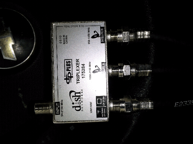

Update....Both tv's are on cable and both on the same channel. I have no way to post a picture right now. I looked at the box behind by receiver and it says something about satillete in, in two places. Both places having a cable running from the receiver box to it. It was also installed from dish, being it has there name on it. The 3 way is in fact also a splitter. Sorry I can't be specific then this. Also, it is model 322G and both are set to channel 73.
Is this the box.you are talking about?
Yes that is the "box" I'm talking about that I'm not sure what it actually does.
That is a triplexer. The 2 satellite in ports must stay connected to the reciever. The third cable, usually marked with a yellow flag is what feeds your secondary TV location.
The single cable on the other side is the dish/tv2 signal path cable. Somewhere along that signal path will be a smaller splitter looking device with 3 ports. An in/out port, a uhf/VHF port and a sat port.
The sat port is what is connected to your dish. The in/out port goes to you reciever location and the uhf port goes to TV 2. Only cables that can be split are uhf/VHF ports. Or when you pull the reciever out and you see the cable coming from home distribution port that one can be. Split as well. Do not split sat feed or in/out ports. It will not work.
I can't help you much more than this unless you put a detailed description of cable paths and what each parts wording that is.
What I recommend for your son is purchasing a wireless video sender reciever and plugging it into the RCA out puts on the tv2 side of the recievers out puts and just send that signal wirelessly to your sons TV. It may save you a lot of headaches.
Where in the mix is the 3-way splitter you're talking about? There should be no reason why you're not getting video off the splitter if the line from your Kitchen tv is attached to the same splitter. You have confirmed that the new tv in your son's room has the tuner set to cable mode? If you can trace the path of the line from the Kitchen to where it originates from, that is where you need to connect the line from your son's room. Whether that location is on a 3-way splitter behind the rcvr, under the house, or outside, you'll have to figure that out.
The 3-way is, in fact, NOT a splitter if it has SAT ports anywhere on it. This seems to be the situation I described in Post #7.
