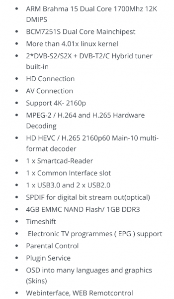

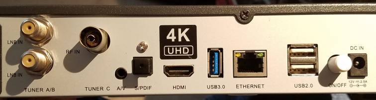

Here are some general specs and a pic of the H7AC Model that will be coming out soon. I don't need the ATSC tuner that comes with the H7AC, I wanted strictly satellite.

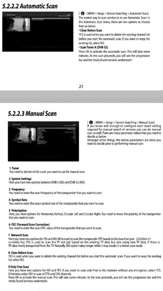

But for me, I originally started with OpenATV 6.0 firmware stock from the factory. From within the Menu, you select Setup, Service Searching, and either Manual Scan or Automatic Scan. You select yes for Network Scan so it knows to search the Satellite for new TP's. It's called Service Searching in the menu, it's the term frequently used over in Europe and the UK.
My only issue was the OpenATV 6.0 firmware wasn't moving my dish motor for some reason, so I reflashed my H7S to the next supported Firmware called OpenPLi 6.0 RC; where the menus are all still listed pretty much the same way. I also had to go into Tuner Menu to set up my Dish Motor coordinates with USAL'S. The Tuner Menu is automatically set for Universal LNB which I have, but you can choose whatever LNB you have. I will send a pic straight from the owners manual that you can in fact see for yourself that my genuine H7S does in fact scan in channels from different satellites.

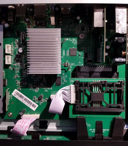

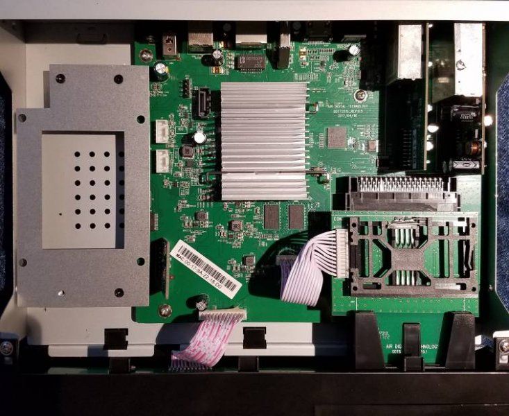

Well, there was a good 2 or 3 month delay before the factory went into full production two weeks ago. The delay was caused by a significant change of the front panel design, otherwise everything remained the same. The circuit board in my H7S has a date of April 2017, all highend Boadcom parts inside, as well as Silicon Labs Satellite and Cable Tuners. OpenATV 6.0 is the same firmware that still includes the Service Searching options, I wouldn't know why your not finding that in the menu?

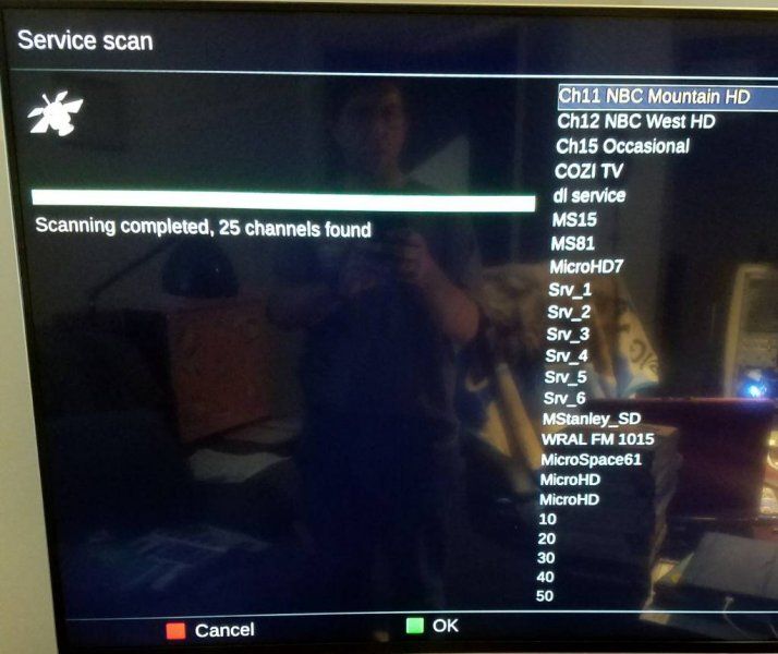

Did you try a Service Scan or Manual Scan using the directions I posted above? It's called a different name, but still functions just like a Blind Scan, as you chose other options to clear out your existing channel list as the box searches. The box I have is working beautifully with OpenPLI 6.0 RC, I did a fresh Service scan of the the three big Ku Band satellites.

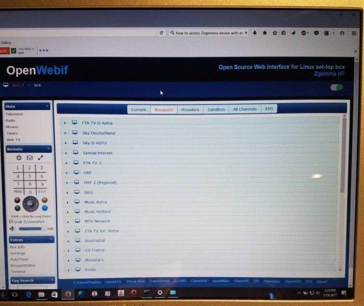

Full production H7S boxes even let you access your box from any computer or smartphone browser. You can watch your favorite channels streamed to your tablet or phone from about anywhere. You can also look at the technical specs of the box from your computer. Just enter the H7S IP Address in the browser address bar.
Yes, used the Service Scan, Network Scan, deleting the pre-populated transponders. I'll have too look at the tables for the services found and missed to compare and see why not all were logged.
Have used WebIF with other STBs. Nice App. I haven't had much success with casting 4K stuff on my network. The HD and standard def works great.

Ok, I may stand corrected a little bit. I tend to associate an Automatic Scan and Manual Scan as a Blind Scan, since everytime I've run one on this box, it refreshes the channel list. But within the Manual Scan, you can enter the specific TP info you know of and scan for that, perhaps updating the TP Table.
