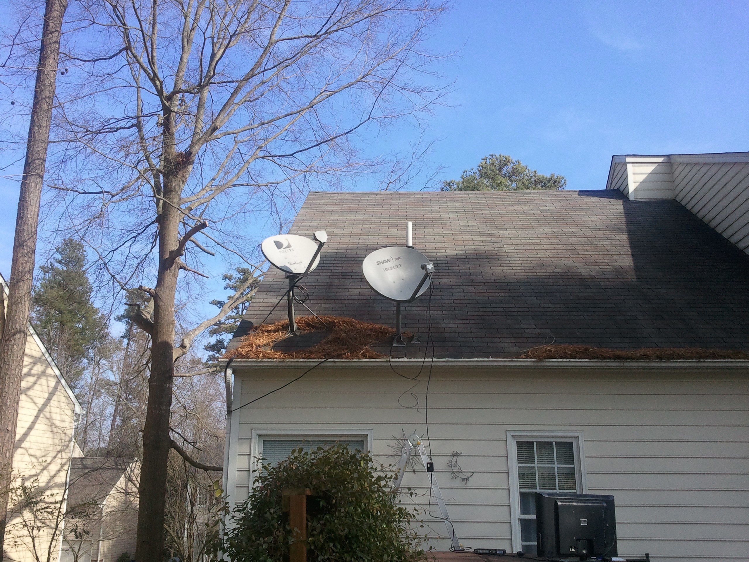

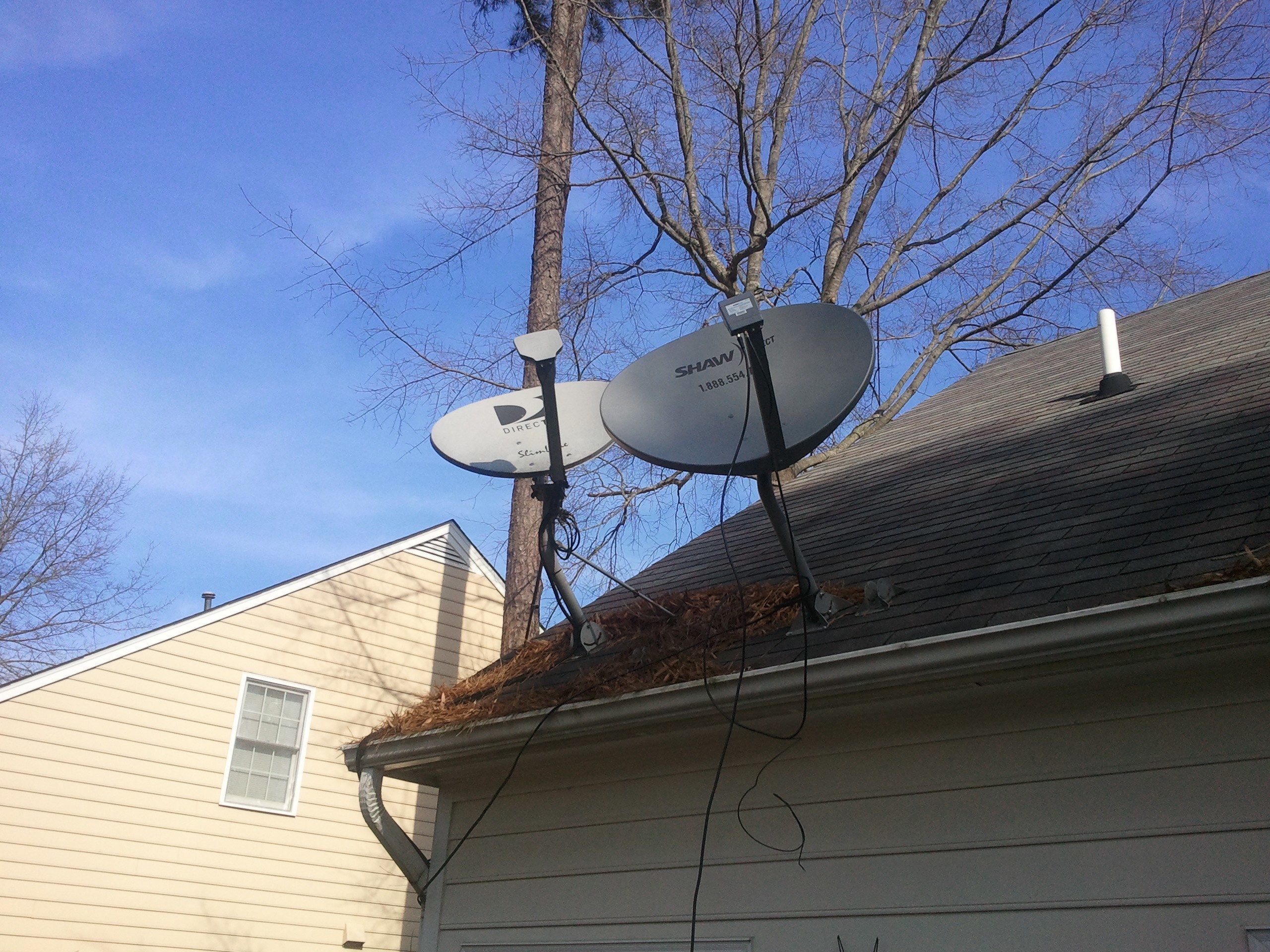

OK it is finally nice here so I am trying to get my Shaw HD channels here in Raleigh, NC I get a 97 signal on channel 252 but 0 on 700 or 300. I have been fooling around with this for 3 hours :(
1. According to dishpointer my skew for Directv should be 62 for my 5 LNB dish and for Shaw it should be 119 if you look in the pics shaw at 119 looks at almost the same angel as my DTV dish ? I have tried moving the skew to what says 160 and slowly moving it back to 120 and still nothing on 300 or 700 just a bunch of red bars at some spots.
Also when I cover SAT A I lose all signal on channel 252 is this is correct ?

Starchoice dishes have zero skew at 90 degree marking on back of dish. Our actual skews are about 30 degrees. Set yours at 119 on back of dish.

I get I get SignalT1 (252):97, Ecb/No:8.9 db) the same as you. I have mine set at 119 at the back of the dish already

OK it must be aiming because the winds in Raleigh today were gusting pretty high, I switched over to channel 700 and the signal was all of a sudden coming in between 30-60 and when I tuned to the channel it was coming in and going out, so I need to adjust yet again, thanks for all the help/tips guys.
make sure the base of your dish mount is solid. if wind is creating that much variance, it sounds like it may be soft. In Wisconsin, we routinely get winds 40-50 mph in the winter, and my picture is always steady.
