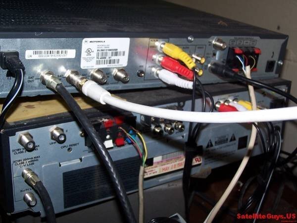

this is the connection on back of 4600 and 905. The wires for the servo motor and dish positioner are there because I had this connected to another dish but since I am presently connect to a lnbf, I don't think I need them.
Well I was going to post some pictures here but I guess I don't know how. They are in the photo gallery.

What is the other sat in sat out for? Ku?
