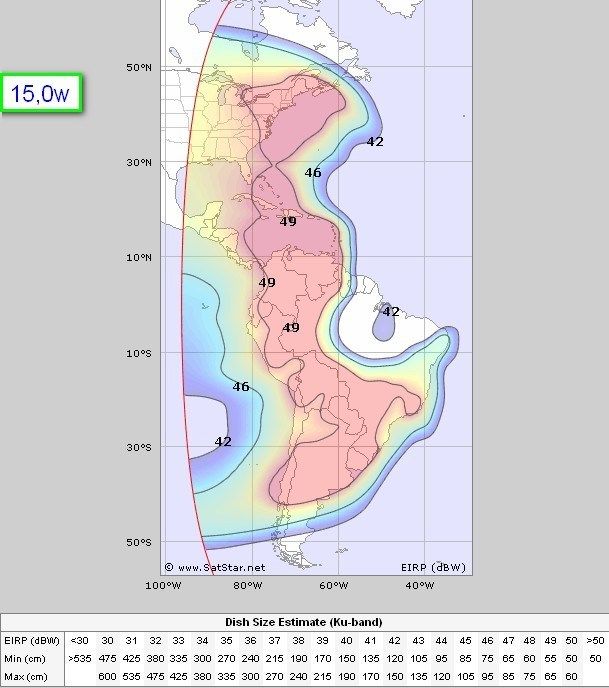

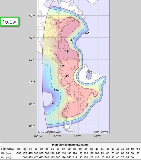

Been looking at the footprints for 15W at Satbeams. Seems I'm well within good signals for a 33" dish.

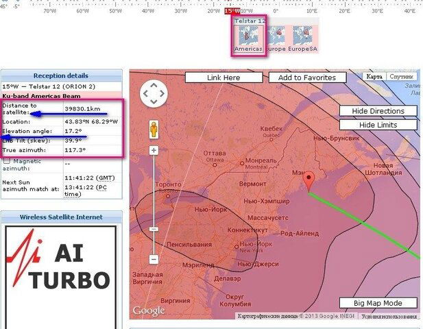

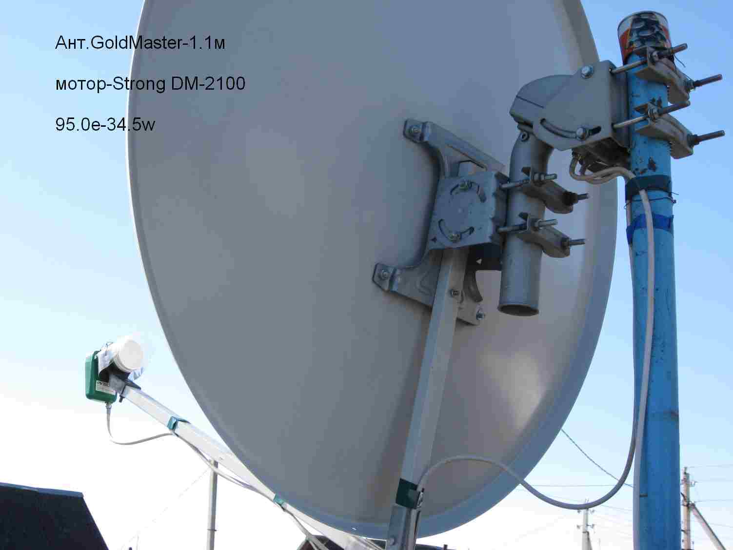

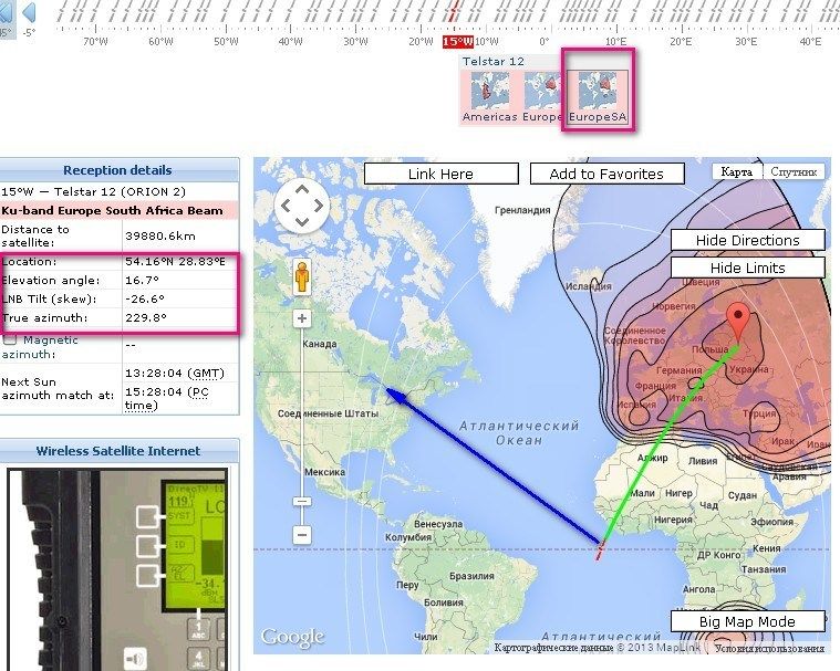

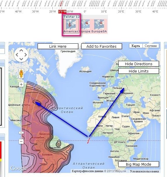

Has paid attention to companion Telstar 12-14,96 ° W. And it that almost equally shines both to Belarus and on Canada-Toronto. And to look at a card the identical distance will be. And a signal excellent in the USA-Canada and at us in Europe. On 15W at me an excellent signal, = the motor = - Dish-1,1 m.-85-100 %-quality - receiver Openbox-820 ci.?hannel your news =MSNBC=11531 H 3198-7/8 and in Europe at us goes, is now cloudy-signal on it of 85 %.
And it is interesting, what the signal at you - =quality = in Canada will be on Dish-1-1,2 m.

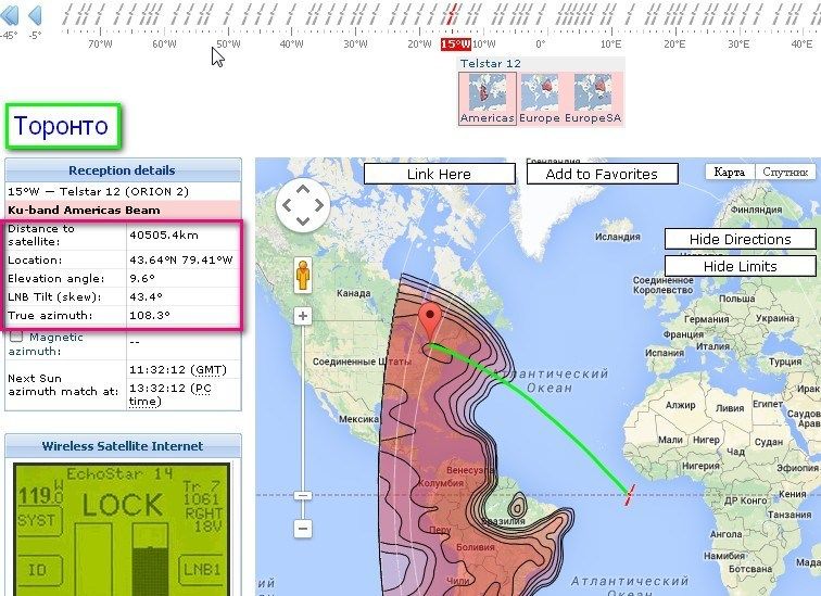

Good morning a forum.

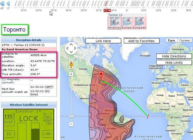

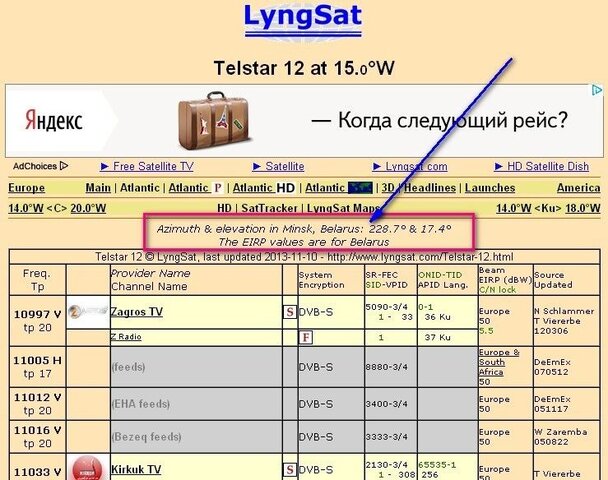

=jorgek = companion height in Toronto a little above, but has almost guessed. How will adjust on frequency 11709 V 3195? MSNBC, =jorgek=????? it is interesting to learn what signal. And exact height near to Maine. Almost identical height and with Minsk-39825 of km.
Торонто 15W.jpg 15w-Ðмер-.jpg http://www.satbeams.com/footprints

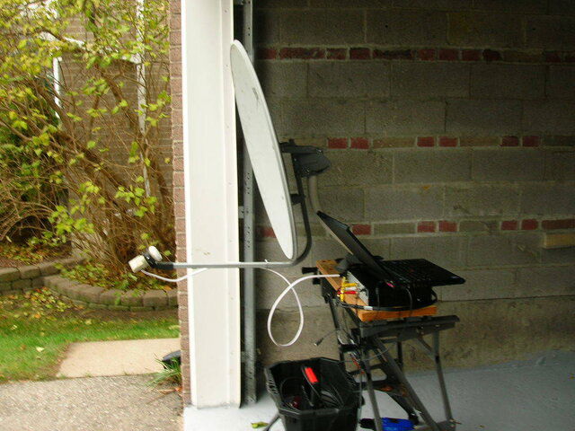

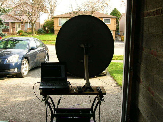

Great day to sat hunt. The temp is 50F and all the leaves are on the ground. Finally LOS to Telstar 12.

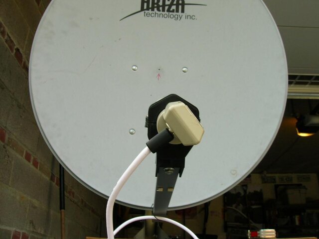

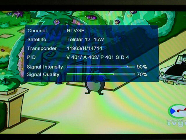

As promised I setup my 33" in the driveway and scanned in Telstar 12 @ 15W.
Took longer to set up all the gear than to find the bird. Took about 10 minutes to home in on the sat.
I have to give credit to Dishpointer.com for helping me.

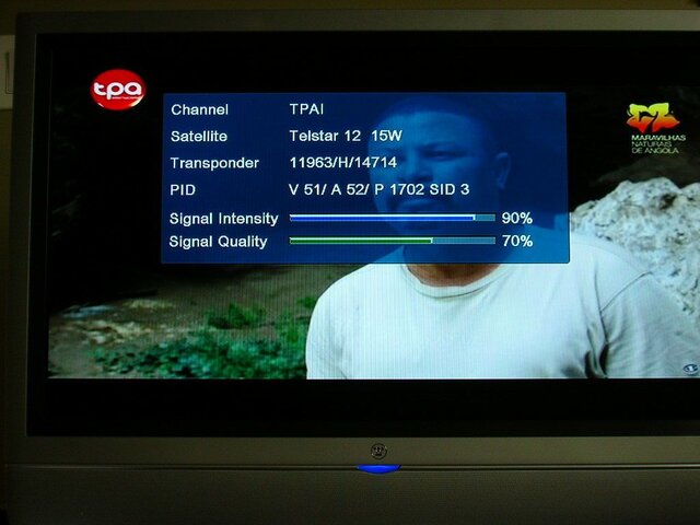

Scanned in 79 channels of which TPAI and RTVGE are ITC.
TP 11709 (MSNBC) was not found.
On to the next challenge.

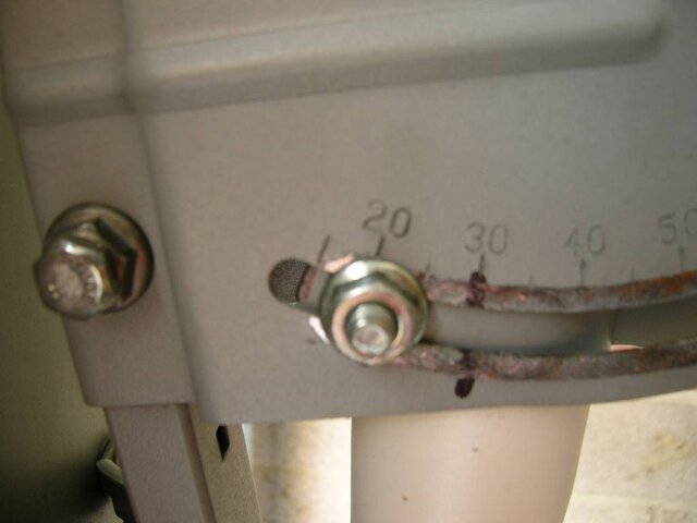

Forgot to mention the elevation markings on my dish are spot on. Dishpointer was 9.5o ​and the elevation tab is just below the 10o​ mark!
