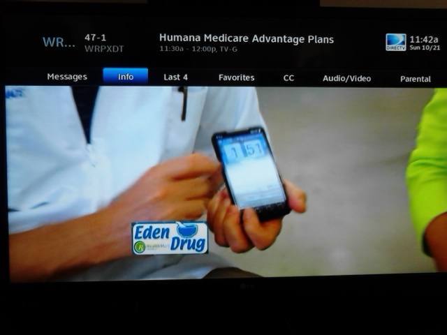

If you add a secondary zip code for a market that has the proper RF/PSIP combo for you channel 46-1, you will be able to see the CW channel. The guide data will show incorrectly, but at least you'll be able to tune to it.
Example: I have an AM21 and HR24. There is a low power channel 47-1 locally that is not in the Directv database. The neighboring market (Raleigh) has an ION station on channel 47-1. I do not receive the ION 47-1 OTA usually but I do receive the LP station as it is less than 20 miles away. I receive most of other other OTA channels from Raleigh and thus already had the secondary zip code in my AM21. Here is a pic showing guide data for WRPX 47-1 Rocky Mount, NC ION. But the programming is actually "Eden Drug's Solutions for a Better Life" on WGSR-LD 47-1 Reidsville, NC. WGSR also has 2 subchannels (the -2 is a SD repeat of WGSR-1 and the -3 is another local LP, WMDV Martinsville, VA) but the subchannels do not show on the -2 and -3 of WRPX on Directv. Play around with it! Maybe you can find another CW in your time zone on the correct channel so at least prime time would be correct.

just plug a zip in as secondary and it should work
It would let you "tune' the station. Any recordings would need to be manual without depending on the guide data.
If you use a CW station yes the guide will be off....but you can manually set a recording (or just record the timeslot)
Yeah, like if I wanted to record "Eden Drug's Solution for a Better Life" I would just tell the Directv receiver to record "Humana Medicare Advantage Plans." You can leave the SD version of the CW channel in your favorites list, too, just to have the correct guide info there. Theoretically, they would appear sequentially on the guide.
