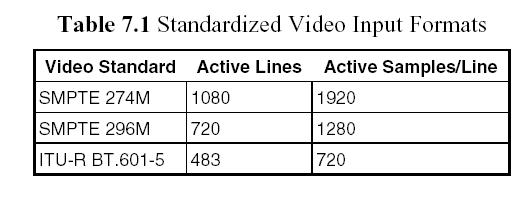

Page 15 section 7.1
"While not required by this standard, there are certain television production standards, shown in Table 7.1, that define video formats that relate to compression formats specified by this standard.
Table 7.1 Standardized Video Input Formats
http://www.satelliteguys.us/voom/december2005/table71.jpg

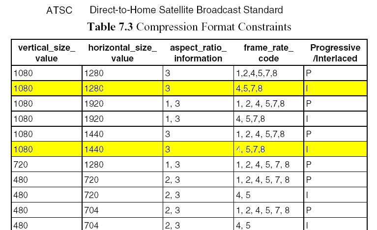

7.3.2 Compression Format Constraints
The allowed compression formats shall be as listed in Table 7.3, and for 25/50 Hz video Table 3 in ATSC A/63 [5].

Going back to those tables I posted, it looks like what they are doing is according to what the ATSC standard should be for compressing the Video signals of 1920x1080i. Good bye good old 1920x1080i...

What are the values representing in the "Aspect ratio" column? Could they represent 16:9 (HD) and 4:3 (SD)?
If so, then notice how 1280x1080 shows only "3" in that column versus 1920x1080 showing "1,3". Could it be that 1280x1080 is the acceptable norm for a 4:3 broadcast instead of the full 16:9?
As a user, my expectations are that HD be broadcast in the full 16:9 aspect ratio...not the substandard 4:3 ratio. Especially if the original broadcast was filmed in 16:9 aspect ratio.
1 = square samples
2= 4:3 displays
3= 16:9
