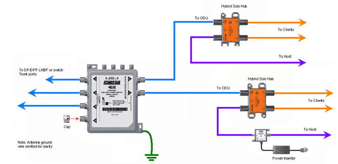

Let's make this simple. The ONLY way to run two Hopper 3 DVRs is to use a DPP LNB (not a DPH LNB) connected to a DPH42 switch (no other switch will work) the two lines from the switch can either go to the "Hybrid Duo Hub" (this is ideal) or, if necessary in the absence of an available Duo Hub, two "Hybrid Solo Hubs" may be used with one line from the switch feeding each Solo Hub. In this configuration the two Hoppers won't be able share recordings. A possible workaround is to run a line between one of the client ports on each of the two Solo Hubs. This should link the video network between the two hubs and enable sharing between the two Hoppers, but I don't know for sure if this trick still works. You should be aware that the Hopper 3 cannot be installed the same way or with the same equipment as all the previous Hopper models. A "Node" any Node will not work with a Hopper 3. If you're looking at instructions that include a Node, they're the wrong instructions and won't work with a Hopper 3. The Hopper 3 MUST be connected to either a DPH LNB without a switch or to a DPH42 switch with a DPP LNB. One or the other, not both. Again, if the instructions you're looking at don't have a DPH LNB or a DPH42 switch, it's not meant for and won't work with the Hopper 3. A DPH42 switch cannot be connected to a DPH LNB. A Hopper 3 cannot be connected to a DPP LNB without a DPH42 switch. A DPH LNB can support two Hopper 2 and earlier DVRs but can only support one Hopper 3. When a Hopper 3 is connected to a DPH LNB, the second port on the LNB becomes unusable. For all these reasons, you need a DPH42 switch to feed the two Hopper 3 DVRs and a DPP LNB to feed the switch. There is no other way except to run each Hopper 3 off of separate DPH LNBs. Which means each Hopper 3 would need a separate dish.
Note
DPH LNB = Hybrid LNB
DPP LNB = non-Hybrid LNB

HipKat,
Yup grabbed that diagram a long time ago when I first started investigating. Have referenced it many times throughout my questions. But still got variations.

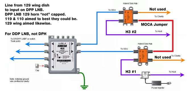

This is what they did . . .
This seems wrong. Shouldn't the line from the 129 wing dish, in this case, go straight to the switch instead of the input port on the other LNB?

You don't want a DPH LNB because it can't support two Hopper 3 DVRs and it can't be connected to the DPH42 switch which you need.
It can, but wasn't. Although it would have been easy. And I seem to think I saw only 3 ports on that side. I have to go back up and check things out, find a couple lost bolts to the chimney cover, see how off center the remounted 129 dish is and if it'll make me nutz and how easy to move if I choose to do so . . . I'll take pic of the install. I might even pull it all out of the chimney so you can see it. But there was a lead from the 4th port on the DPP LNB, if the wing dish was ever needed to be reattached, and that's what it was attached to. At that time I was adjusting from the "changed" version of the install, trying to remember how the last installer and I wired for future proofing which was perfect for this and preparing for the worst.

I was thinking the same thing. While the DPH42 switch is connected to the LNB, it would disable the switch built into the LNB, making the LNB input port useless.

Does anything even work with that setup?
If he has three cables from the 110/119 LNB to the DPH42 switch, then I am guessing he is also getting 129 from that LNB, not from the wing dish.
The main dish is aligned so that 110 and 119 are at the best they can be. 129 is really bad. The wing dish is aligned for the best on 129. So I doubt that 129 is coming off the LNB. And supposedly it can mix and match to get the best signal. I can always cover the 129 horn on the main LNB and see if I lose signal . . .
The system will use the best signal it can find but it can't find or access the signal from the wing dish in this configuration. The wing dish needs to be connected to the switch.
