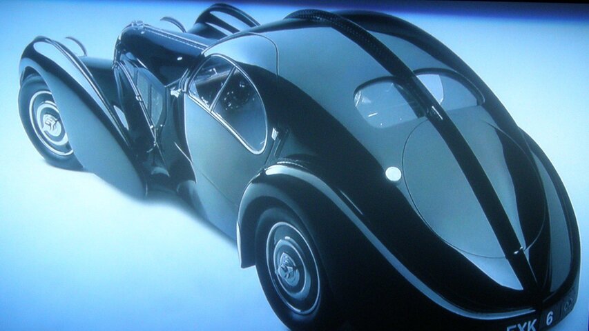

I currently have a Toshiba 50HM66 DLP TV that has just begun having an issue today.
Please notice the nice dark wedge on the top of the screen. Does anybody have a clue what might cause this? This happens with both my Directv HR20 and PS3 connected via HDMI and component.

I have a 56HM66. This is a known issue at Toshiba and you will need a new light engine. Fortunately, Toshiba issued an extended warranty on this problem and will replace your light engine at no charge. For further information, check this site:

This is good news as my serial number is one that shows it may be impacted. I also have a extended warranty that will also help with the fix. Now my question is should I allow Toshiba or Best Buy replace the light engine? I am assuming that Toshiba just outsources this type of work also.

Well Best Buy was out yesterday and they put the new light engine on order for me without any question. They were well aware of the Toshiba recall and that did not make a difference. Now it is just a waiting game for the part to get here.

Thanks to everybody that responded with information. BB was out today and replaced the light engine and bulb. Now the picture looks just as good as the 1st day that we brought it home. The only thing I wish is that they would have just left the bulb and let us replace it at a latter time. The one that was in it know was only 4 months old.
