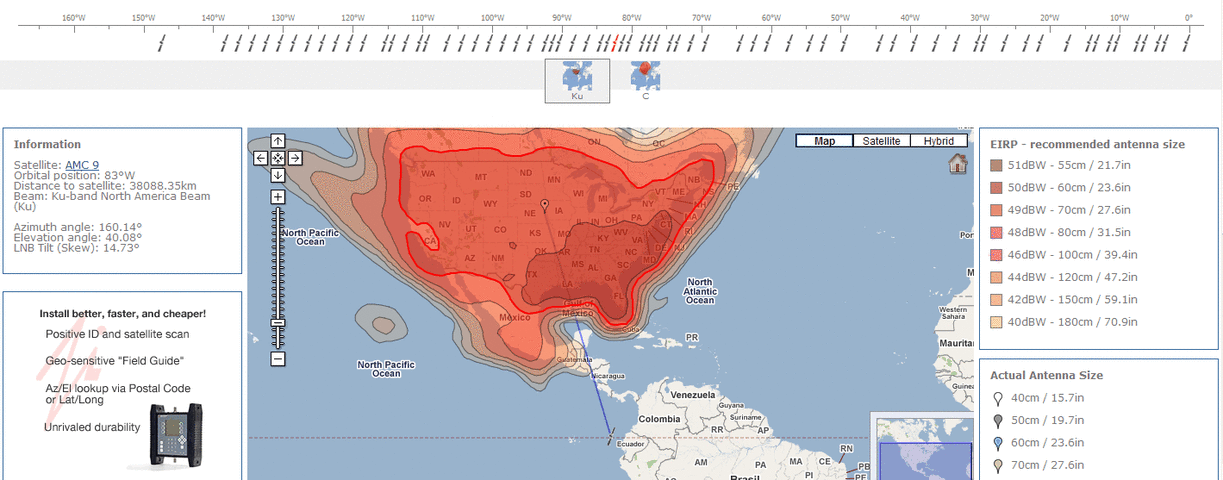

Where are you located? I am approximately 40 miles NW of Omaha, NE and I have a Winegard DS-2076 dish (76cm). The receivers I am using are the Coolsat 5000 and the Fortec Star Dynamic.
I am supposed to be in the 50dBW zone which requires a minimum dish size of 60 cm. My dish is fairly well above that in size.
Refer to the attached EIRP MAP.
