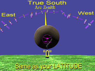

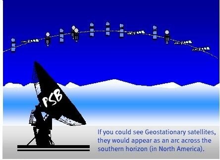

Yes your TRUE south (ZENITH) is in the middle of the ark and is your highest satellite in the sky.
Its not a good idea to use a motor for anything other than the satellites within its arc, some people do use two motors in two locations to cover the arc.
Make sure the mast/pole is EXACTLY plumb. In fact I off set them to take into account the weight of the dish/motor.

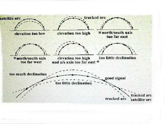

Once you have set the motor elevation do not touch it again, the dish elevation can be changed to peak the signal, check some of the below pictures for some tips.

ok, 1st-- thanks PSB for such an early helpfull hint, ( do you ever sleep!!!) i like these pics,,now i read your comment about 2 dishes in differnt locatiosn to cove the arc, my confusion with that is if they are still on my property isnt the tue south and the arc the same??thats where iget miffed, i would have thought that one motor would start deep right and move on a arc up to the zenith,where as the motor to the left would start deep left and move up to the zenith??

Unless (Like me) you have an EXACT true south satellite, yes set up the satellite on your receiver using USALS, the dish/motor will move slightly.
THEN manually move the assembly west/East until you hit the satellite, the dish elevation can be changed but the motor elevation should NEVER need touched!
