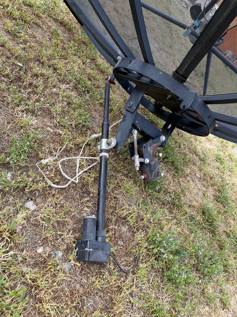

Well, I bought the dish. $45. No idea if it'll work. Here some pics. What some first things I should do to it? I haven't measured it yet, seller said 6ft but seems bigger.
View attachment 162184View attachment 162185
First off measure it to be sure what size you have. Hopefully it is bigger, as you said it looks to you, and you can get a decent amount of channels. If it is 6ft then it will still get some of the stronger signals but reception will be limited. At least you would be able to get your foot in the 'c band door' with it.
I can't tell for sure but it looks to me as though the lnb rods are bent? If that is the case you could try to straighten them but another option would be to get a few pieces of similar sized conduit from Home Depot or Lowes to form new ones using measurements from the originals.
Before doing that though you should do a string test on the face of the dish to make sure it has kept it's shape. Post back your results. Good luck with your new hobby! :)

Yes rods are bent, I'll try and straighten them.
LNB seems quite old, think it'll still work or should I just buy a titanium lnb now? The guy said it did work before though.
I asked if it was already aligned and he said yes so I assume I get a pole plumb and aim it, it should work. I recently set-up a 36" motorized ku dish so should be similar to get it aligned.
But the question is, I don't have a box to move the actuator. Is there a way to manually move it? The wires are all cut but I'll take a look inside and run new wire if there's a label inside.
Two 12 volt car batteries in series for 24 volts DC, wired with a center OFF DPDT switch that's cross-wired, to reverse polarity when flipped to either side. Though, you'll tire of that quickly, it'll work once you find the first satellite successfully.
Or buy one of these: SuperJack C-Band Dish Positioner | Tek2000.com
Man, i hate to say it but those support rods are going to be difficult if not impossible to bend back. Usually once a thin metal tube is bent once, bending it back will just break it apart. I know from experience. But, if you have just one good un-bent tube, you can use that as a template to make more and replace any can not be saved. That plastic piece between the rods and LNBF is just there to hold a LNBF Cover so you dont need that which is good. The LNBF let us know more about it, make and model, maybe some close-up pictures. If it is old, most likely it will need to be replaced, only because 5G interference is really getting to be a problem. But you can always try it out and see how it works for you.
But a 6FT Dish is pretty undersized today. They worked great back in the day, and you will get SOME C -Band signals on it, but you will also miss MANY, including the DVB-S2 signals as they are weaker. primestar31 offered you sage advice. Plant your pole deep enough and tall enough to support a 10 Footer. Once you have has a taste of C Band, you will want to do it right and a 10 Ft is what you need these days. That said, if you find a 10 Footer, you can use your 6 Footer for a stationary dish, or even convert it to Ku Band or something.
A DiSEqC Dish Positioner is what you really want, but these are HARD to find these days. No one is selling these in the USA right now that i know of. You can find old Dish Positioners on ebay, better than nothing i guess, but if i was you i would find a DiSEqC Positioner, such as a V Box.

If the rods are bent too much they won't straighten properly and your lnbf will not be positioned where it should be. If that is the case then you won't get a proper signal and you will need to do the conduit method of replacing them. This is especially important if it is a smaller dish as any loss of signal may make it useless for reception.
The lnb may still work but without a positioner that can run the polarity motor you would be best to replace it with a new Titanium lnbf as the polarity is voltage switched with those.
As primestar31 mentioned above you can move it with batteries and a DPDT center-off switch. Make sure it is a heavy duty type to handle the current. Here is a wiring diagram for doing it.

Dish is 7.5ft, measured yesterday so better than the 6ft expected.
The rods may all be bent, I'll add pics later today including LNBF info.
Dish definitely is going to need some work. The mesh also needs fixing in some areas.
The LNBF brand is Chaparral but I need to check which model later.

Next question, my actuator (which works, been moving it using a 24v 2A ac adapter and just switching the (+) & (-) wires to move either way) was mounted on the left side of the dish (when looking from behind). This allowed the dish to easily pass beyond 139W which was useless to me. I want to get 58W and when I moved the dish all the way that direction, it stop around ~ 72W (you'll see below how I know this). I ended up switching to the position of the actuator to the right side, which still allows it to get to at least 139W (perfect) and when moving all the way towards 58W, I feel like it's still stuck around 61W? (Won't know for sure unless I check 61.5W).
Am I missing something? I already changed the actuator limit, the reason it stops is because the actuator arm itself is basically touching the dish mount (i'll add a pic later).

For the actuator, post #21 shows how I got it and which side it was mounted on: Trying to get into C-Band, may have found a dish?
I moved it to the other side. The dish goes up to this point:
After this point if I let the motor go further, the dish basically falls down until the bolt and actuator hit each other:

For the actuator: Yes, it is clear that that construction should be changed!
