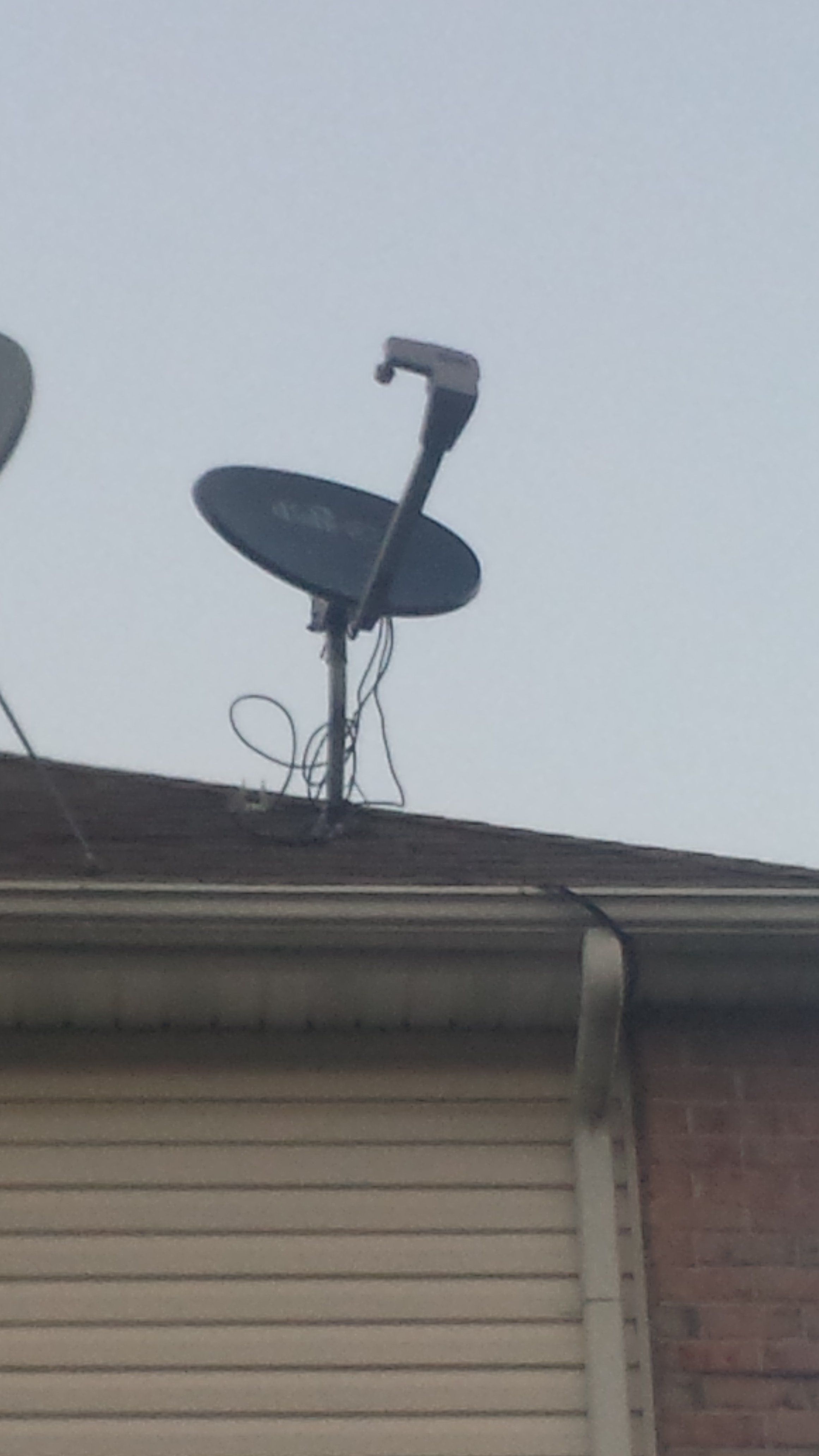

This is what I would do if I arrived at your house and I saw this, I would call the last event provider. I would send a pic to to my FSM. Extend time and reinstall your system. I would run new coax from the dish, check to make sure your mount is secure, and replace small parts and unapproved fittings if any. Most likely a fresh install down to and up to the receiver because a lot of the techs are Dirtbags and do sh*t work in and out.

I bet that POS didn't even ground it, messenger, or the whole system. I would check, and make sure it's secured as a whole.

Wow what a horrible lazy install....#1 I would never allow anyone to install a dish on the roof interfering with shingles and just 1 more avenue for a possible leak...I would demand taking it off the roof and fixing the holes that were done by this skimpy install..If he was so lazy about not properly and neatly running the RG6 I can only bet there was no consideration taken for your roof and possible leaks!...What an arsehole!!!

Is my Dish also missing the rear supporting bracket? Or is that how the new Dish Satellites come?
Not all dish mounts come with supporting brackets.
Had complete loss of signal and a Dish Tech installed a new Dish. What is with all the wires hanging off the new Dish? Are there any Dish standards for aesthetics?
Wow. That is a terrible install. The dish doesn't even look like it's in focus!
The number of fails for QA in the picture alone are rather high on this one, no drip loop that I can see, improperly secured wiring, and excess wiring just to name a few and I'm sure that there are more that aren't in the picture. That would definitely not even come close to passing QA muster if inspected and needs to be completely redone. +

The tech may just forgot to tight the wires, may be was a rainy day :rain, or he just need to take a leak ..... :oldno
The drip loop is in the gutter ;)
The visible 3 wires are exactly one-two loops behind the dish.
What kind is the second dish - 500+ international or DirectTV?
