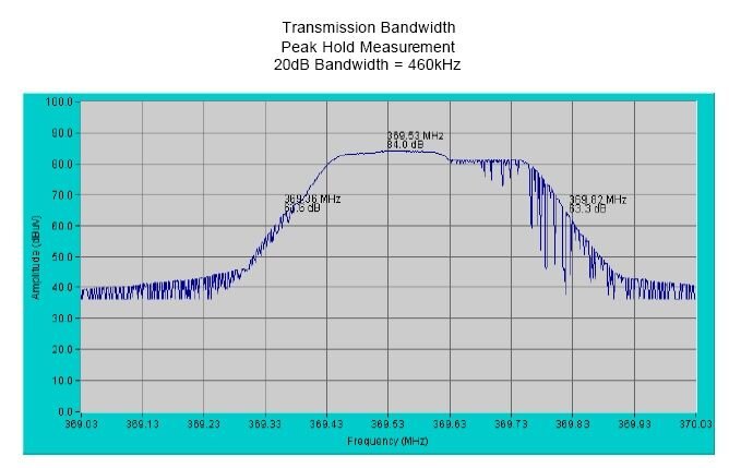

I won't challenge you guy's freq counters, but perhaps they are being affected by FSK harmonics. I've attached a spectrum analyzer plot for the Dish 8.0 UHF remote (FCC ID: DKN-FSK01). This is right out of their FCC compliance report, completed by a standards testing laboratory. The FCC is pretty fussy about this stuff!

I'm a HAM radio guy, so of course, I also have a frequency counter laying around...
Mine shows 0369.5000
I tuned a ham radio to that frequency, and then hit some buttons on the remote, and get a carrier, and some digital sounding junk, so I'd say that's it.
I'm not sure if 433.1245 is for an older model remote, or maybe you were picking up a stronger signal from something nearby. Remember the signal from the remote is quite weak, and the freq. counter can easily lock onto something else.
