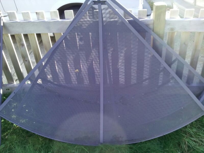

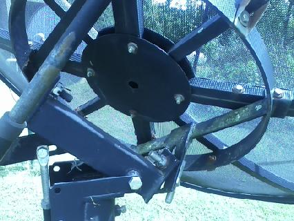

Here's a pic of the cleaned up panels - It turns out they're not black or green - They're gray!

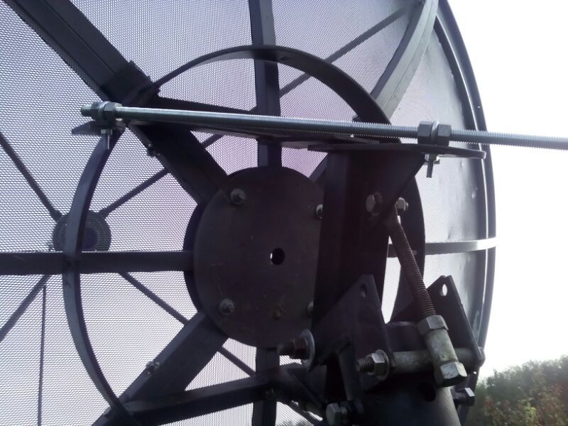

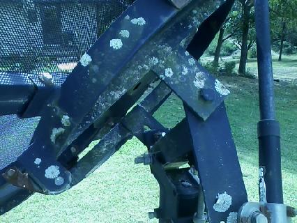

Would agree with waylew. Either a bushing or bearing that are siezed/rusted. Once you get the bolts out, you will know what it is. If just a brass bushing, then you may be able to salvage them, if bearings may have to find someone with a press to press new ones in. Brass bushing can be machined fairly quickly and thus shouldn't cost to much to get made.
Keep us posted.
edited for clarity.
Ya you guys are right - Both adjustment rods are rusted tight and it has washers between the pieces. I need to dunk all of these parts and see if they'll move. Not sure what metal the washers are. I'm going to get the main parts media blasted and painted and I'll rebuild it.
Thanks for posting the pics phlatwound - great to know its not missing parts.
It's hard to be sure that certain parts are supposed to move, but I have the Declination adjustment rod in a bath of acetone and transmission fluid. In a day or two I'll see if it frees up.

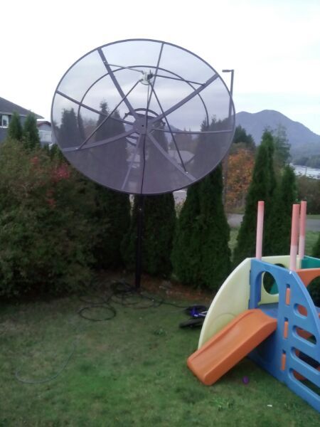

I rolled the dish upright, aimed it at my true south (125 deg) and locked the available transponders on my super buddy a2.
IT'SSSS ALIIIIIIIIVE!!!!!
My dish is motorized now - the Venture 18 came in today. I hooked it up and things are working really great. The Titanium ASC-1 is awesome! So easy to control with the A3 and with the remote that the ASC-1 comes with - really intuitive. I know I have some adjustments to do, but I'm getting the arc from around 95w-131w. Anyway that's the fun part. I just need to get it connected so it can rain for a few days.

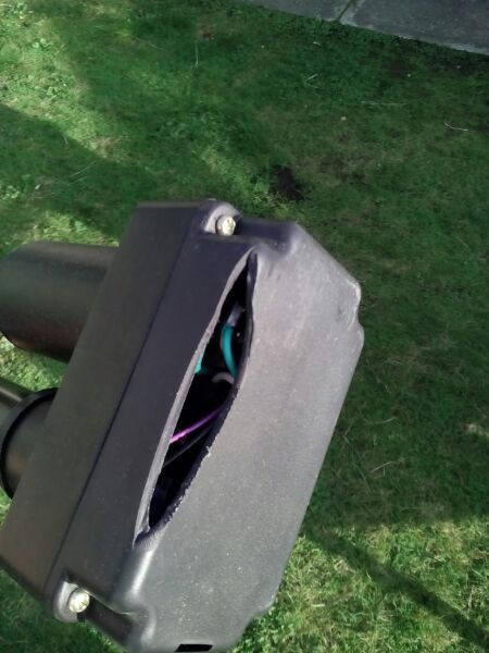

The only thing is that the actuator arrived with a chunk out of it. IMG_20151015_43141.jpg I pretty much just figured I'd seal it up and take a chance - so I did. There was no damage to the box and the missing piece was not in the box at all. There was a very small fragment that was inside when I took the cover off to wire it up. It works fine, so I'll see if I can just get a new cover piece.
