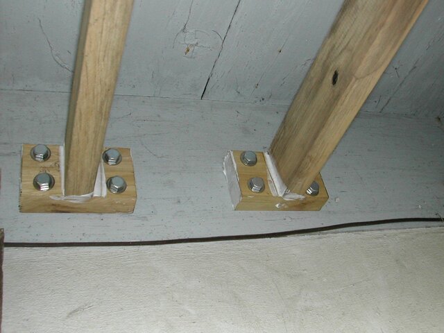

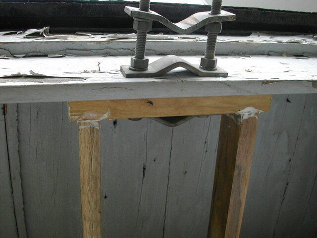

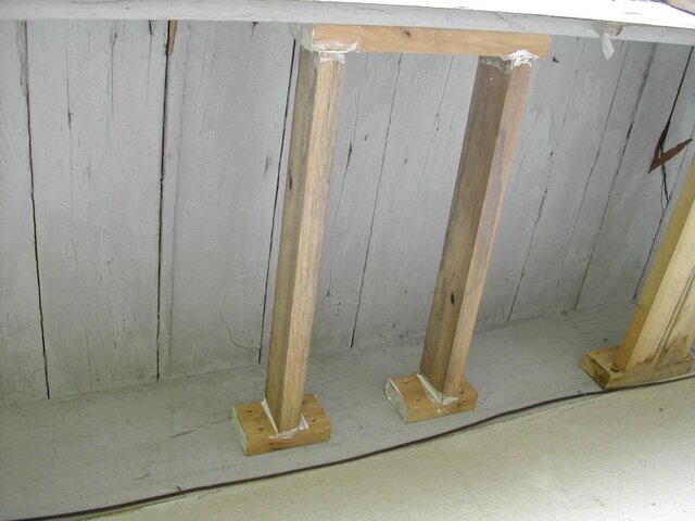

I've been able to do some work on the mounting post for the 1.2M dish between showers :o. Attached are some photos of the brace I devised to help support the post against the eve of the house. I really should have painted first, eh? :eek:
Anyway, #448 shows the brace just sitting in place.
#449 shows it bolted in place with the stand-off bracket mounted.
#450 is a close-up of the stand-off. The white coloration is silicone putty I put on the raw ends of the wood to reduce water wicking into the grain.
#451 is the 3" lag bolts driven into the outside rafter. The 4" crossmembers that the bolts go through are fastened to the longer braces by 3" course-threaded screws (two on each member).
The small brown wire just below the brace is for my rain gauge. The sending unit is on the roof & can be seen in prior photos, looks like a crock pot. Immaterial here, so won't elaborate.
I've installed the post and plumbed it. I'll post pictures on that later (I'm on dial-up, painfully slow sending photos :cool:). I've had trouble with the ISP, so couldn't send these earlier.

Nice job, that should hold things good and tight:)

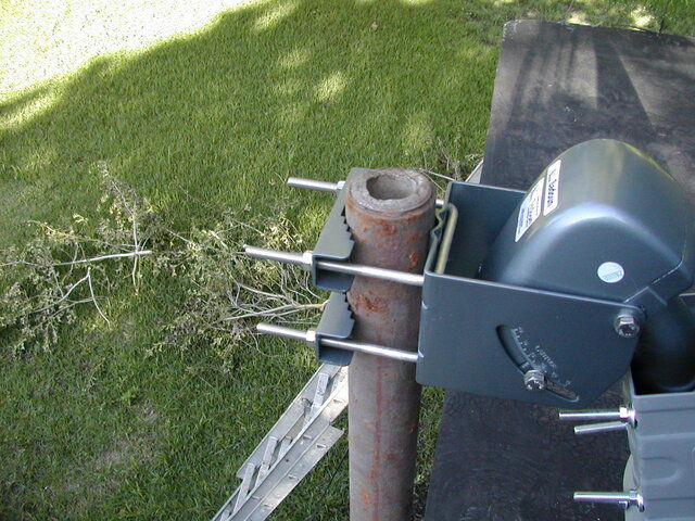

I do have one major problem. The 1.2 is made to mount on a 2 1/2" to 3 1/4" post. The motor has a 2 1/4" shaft (all listed are approximate measurements). The large u-bolts won't clamp against the motor shaft enough to hold the dish. I've got to find a way to shim, or clamp it better. The motor itself has a toothed clamp that will fasten and HOLD on different size shafts, but the dish has just a 1/4" diameter u-bolt that is just too slick to hold well. Again, I ran out of daylight, so that'll be something for tomorrow. I'll get to the photos later. I believe I might be able to send them another way beside this dial-up & get them all there quicker.
The mount was designed to fit on a minimum 55mm shaft. The DG380 has a 55mm shaft and should fit perfectly.
For extra grab, place a strip of adhesive backed 80 grit sandpaper on the mount.
If the mount still rotates on the shaft, you may consider a hardware fix. Once the dish is aligned on the motor shaft, drill and bolt or use a self tapping screw to secure the motor shaft to the mount.

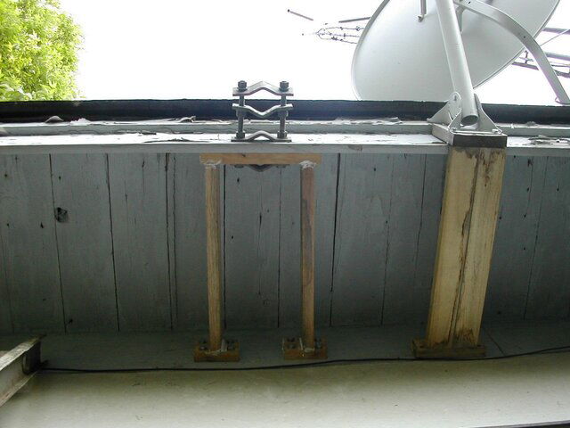

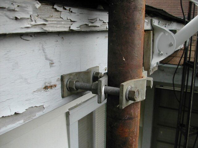

Nice work on the eave mount! I would add some tripod legs to the mast and secure to the rafters or place a stand off 18 - 24" below the eave mount to secure the bottom of the mast. The eave mount will not withstand an extreme wind load on a 1.2m dish. Better safe than sorry!
More photos
Thanks for the advise, AV. I haven't thought of the sandpaper (yet :eureka), but had thought about swapping the u-bolt fasteners, though not fond of that idea at all.

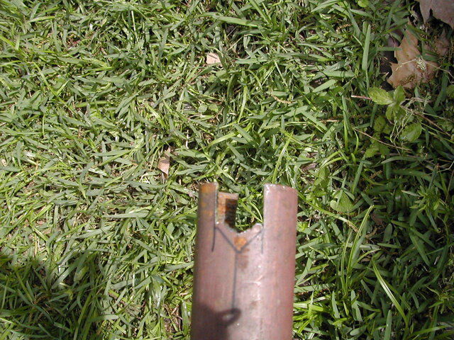

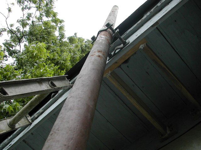

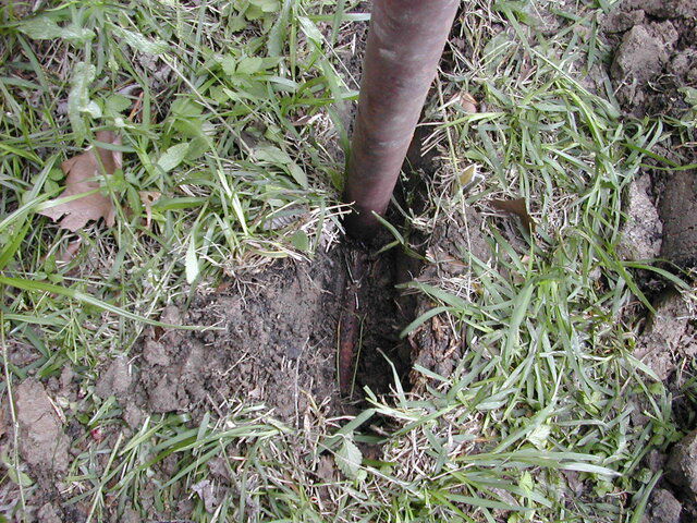

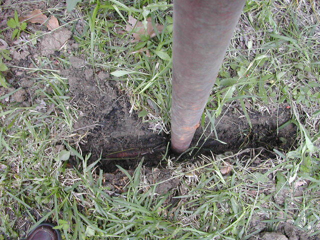

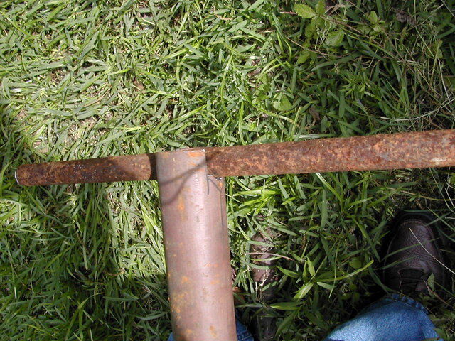

I tried to send photos last night, but lost my connection just about the time I went to submit them:mad:. The mast goes all the way to the ground and is not entirely held by the eve mount. I don't have my list of explanations of the photos with me, but I'll try to call them by memory :rolleyes:.
477 - The notch for the cross member that I used to prevent unwanted rotation of the mast.
478 - The cross member shown in position (for photo only)
479, 480 - end of mast in the ground with the cross member in place.
481 - veiw up the mast from the ground.
482 - close-up of the support brace.
Hope these show up okay. I haven't made photos of the dish yet - got too dark yesterday when I got through.

That is a very robust mast install. Should work fine if the base doesn't move. Have you considered setting the base in cement?
Thanks, AV. Yes, I thought about concrete and may have to go to that, but wanted to avoid it if possible. There's about a 4-to-1 leverage advantage at the ground point over the point where the dish is connected. I.e., 20 pounds of force at the dish would create 5 pounds of force at the ground (the eve is 11' from the ground, the top of the post is about 40" above the roof line). I figure if the ground point moves, the roof would be gone anyway - ha. I realize over time there may be some motion there, hopefully there won't be. The mast is about 8-10" deep and the pipe going across the end to prevent rotation will add additional drag should any motion be attempted.

Dishdigger, You should consider using cement at the ground. It would be like having insurance against the pole moving . On days we get a lot of rain and that area get soft, there can be a chance of high wind from the south playing havoc on that 1.2 meter dish you got.

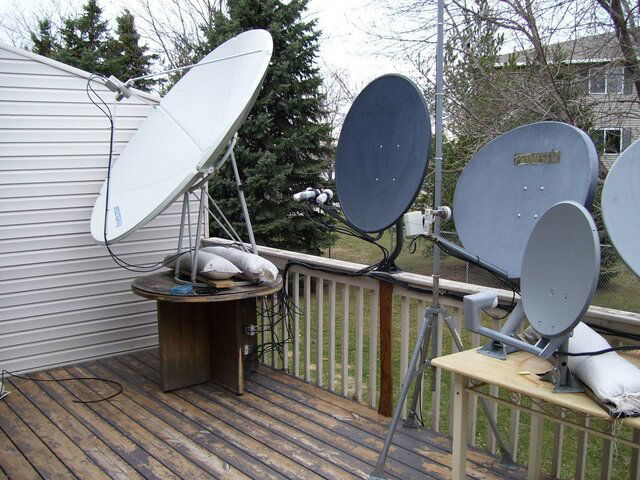

A Little More

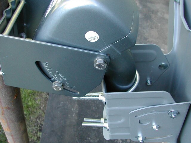

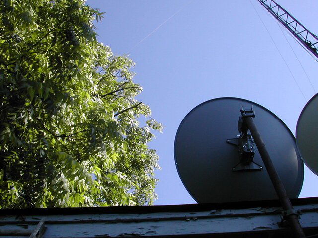

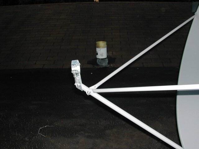

Just a little update. The dish is now mounted and pointed close to 91W, my southmost sat at 180.5 degrees. Brian, if you get to view this, I need clarification on the LNB mount. The diagram with the dish shows (in the diagram for the optional C-band LNB mount) that the side supports fasten along with the LNB mounting bracket. The diagram with the optional bracket shows the side mounts in a separate hole toward the dish from the bracket (the hole I used in photo 488). Which is correct :confused:??
Photos:
484 U-bolts to motor shaft.
485 Motor bracket-to-mast.
487 LOS parallel to dish toward 91W (tree limbs may be a problem. Removed some, try to get others, but may be farther away than my 14' pole saw can reach).
488 LNB support brace.

I have drilled a second hole through the LNBF arm to secure the c-band adapter clamp in opposing directions. Maybe over-kill, but it is solid!
A cemented base with crossbars will make your setup real solid. All the same, Great setup!!:up
Thanks for the reply, Brian. The bracket has one bolt through it and another threaded into it from underneath. What I was asking is where do the side supports connect to the support from the bottom of the dish? The LNB support is shown in two different instruction sheets with the system. One sheet shows the side supports fastened to the lNB bracket bolt, the other sheet shows the side supports fastened where they are in the photo, approximately three centimeters closer to the dish itself. Which is correct?
