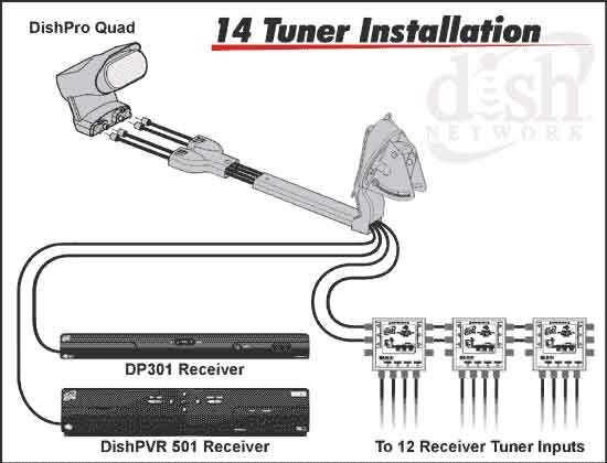

With more than two receivers, the only DPP solution I know of is the DPP44 switch. Keep the Quad, feed two outputs into the DPP44, then send one cable from there to each receiver. Use the DP Separator there to split the cable so each tuner gets an input.
If you don't mind running two cables from the switch to the receiver, you could use a DP34 switch. With that, you'd have two outputs from the Quad, plus four outputs from the switch. It would look like the diagram, without the extra two switches.
Good thinking mdonnelly. A DP34 will be cheaper too. The only draw back is having to run two cables to the the dual tuners but other than that, he should be fine with a DP34 switch.
