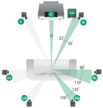

SEE ATTACHMENTS
A correct full 7.1 loudspeaker placement. DD Sounds good, but not the best. DTS specializes in "master quality" soundtracks with far less compression. 8.1 and 9.1 systems add the single rear center and dual rear center between the two back surround L/R. They are only matrixed, not encoded material on the disc.

See #3 attached pic and explanation above your post. That is the correct setup sample for multi-channel sound. Don't go by what you hear, that comes direct from both DTS and DD on proper placement. Rear center will be directly between the BACK/REAR, and behind the listening position. At least 5' away or more based on your room and power. Not in the ceiling/above.
