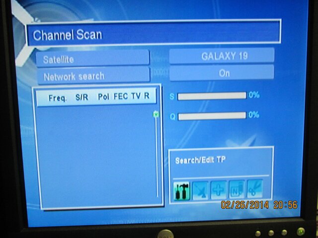

Thanks for suggestions. The Ultra rec has USB input hidden behind small front door, but the Extreme has none. Both receivers have 9 - pin serial ports. The Extreme rec has strictly defined transponder list for every listed satellite, and it probably scans within its "proscribed" limits.
It does have an option to add a satellite, so I did it (added Galaxy 19). But, when I clicked "tools" to add a transponder, it just displays a grey line, and would not receive any inputs from remote. Dead end street.
I did reset it to factory default, and blind scan a few times. It pulls in all older transponders, it just does not "see" the transponders added recently.
Even tried to "fool" the rec into receiving other satellites which have transponders with different frequencies - to no avail.

In your second picture, press okay while search/edit TP is highlighted. Then press F1 to add user TP. They should show up on the bottom of your tv screen. i.e. F1 F2 F3 F4
From the Main Menu select Installation then select Channel Scan. Then scroll down to the Hammer/Screwdriver icon which is the search/edit TP option and hit OK. Then select F1, F2, F3, or F4 depending on what you want to do.
Tried it exactly as you proscribed, but no luck... this new transponder (12184) is not on the receiver's "list"

Your firmware may be corrupted. Post a screenshot after pressing F1 as per my post #6
Could be,as I bought this rec as one of four recs, from - just guess - a hacker. But only now I found on the remote the colored buttons, F1 - to F4.
The screen display did not prompt me to use them. Gonna try it soon, after fixing wet floor in the bsmt. Thanks!
Thank you, jorgek and catamount, for patiently guiding me to use the F key. Somehow looked for a box with this key - only on the screen, finally dawned on me to look on the remote... sorry.
Now the receiver is programmed and works as a charm.
